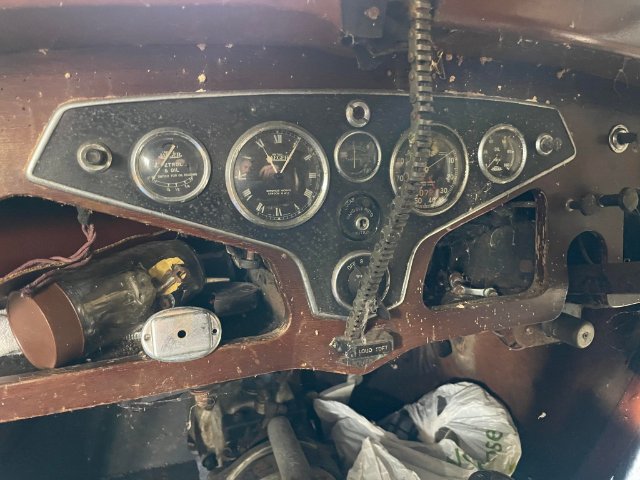

2022 Dashboard
2022 Dashboard

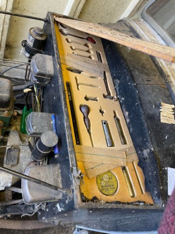

2022 - Toolkit
2022 - Toolkit

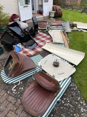

2022 Interior and panels taken down from loft

Hi and welcome to RSR if no one has said that yet. Lovely to see your car even if it is in bits. What an amazing tool kit it was provided with! I have never seen one as comprehensive. You can have fun locating replacements for the missing kit if nothing else!

Hello, Welcome to the Forum. That looks an interesting project. I can see hydraulic brakes, a number of what appear to be control boxes and a startix. The startix was fitted to up market cars and was designed to restart the engine if it stalled, sensing the lack of output from the dynamo.
If the dynamo failed when the engine was running, the startix energised the starter motor with expensive consequences!

Always wonderful to see a previously unknown and unrestored Rover, albeit requiring considerable attention. That said, your car appears to be complete and there is nothing to suggest it has major mechanical failings. The bodywork appears in good condition and the interior parts look usable with only minor attention. There is seems to be evidence of woodworm in the dashboard, but that is cheap to replace. Check the seats as they are also made of plywood; the front seat backs are almost impossible to replace but yours look ok. What we cannot see is the condition of the timber frame in the body. It’s made from ash so pretty hard timber and, if you are lucky, it won’t be too far gone, making repairs and worm killing an option. If the engine isn’t seized you could try to get it running but, since it probably needs to come out of the car anyway, you may as well get it stripped down and checked before trying. Most likely it will require a new clutch and all the ancillaries will need refurbishing. Likewise, the brakes, axle oil seals and any rubber bushes will need attention/replacement. I didn’t see a steering box in the pictures but that will also need looking at along with track rod ends, king pins etc. A lot depends on how much work the car has done and a close look through all the receipts you have may reveal that some things have already been done. These cars are pretty tough and it takes a lot to wear out the metal bits.
All this makes your Rover an excellent restoration prospect. The first thing to do is collect together and document all the parts you have. Take pictures of everything and keep every part, no matter how small, rusty or insignificant they seem to be. Then you need to decide whether you want to undertake/project manage the restoration yourself or hand it over to a professional restorer. It’s fair to say that whichever route you decide upon will be expensive and time consuming. As such, you need to be realistic regarding the time and money you have to devote to this. Failure to do this explains why so many restorations falter along the way as they can become a money pit. With that in mind, I’d suggest that you take some time to visit a few Rover Cub events and get a feel for the scale of the work needed to get your Grandfather’s car back on the road. It’s up to you to decide what level of restoration is acceptable to you, it’s your car now. Then decide how best to approach your own project vehicle.
