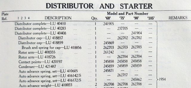

Does anyone have a spare parts catalog that also includes the 1960 Type 100?
I'm looking for the number of the matching Lucas distributor!
My data only goes up to 1959 and doesn't include the Model 100.
distributor list for model and part number.jpg (60.49 KiB) Viewed 116 times
PS: My plan is to use an electronic distributor from 123Ignition, and I need some data for that.

It would appear to be Rover P4 95 & 100 Distributor type DMBZ6A reference 40613D from Ignition car parts advert on Ebay:- 146121556706
"Genuine Lucas DMBZ6A 40613D fully reconditioned in the UK
Sold on exchange basis, there is a £80 refundable surcharge included in the listing price which will be refunded when we recieve the exchange unit.
This distributor can be converted to electronic ignition for an additional £40
ROVER - P4 2.6 6Cly 90 / 100 / 105R / 105S) Jan 1956 to Jan 1964 2639 IOE
