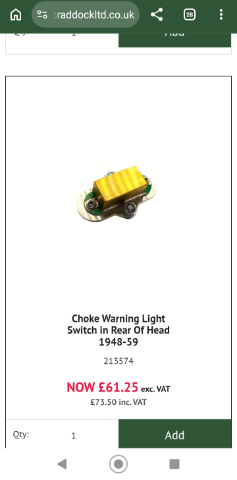

Right this minute, this may not be the greatest help to you but the picture above shows the new switch I bought and fitted. However, after about three years but 100 miles, it has stopped working again and as the car in question is one that has to live off site, I have yet to have a proper look to see what has happened.
The switch will be thermostatic , so when it heats up the terminal (connected to the light) makes contact with earth and the driver knows to put the choke in and go from 4 mpg to 20 mpg . Reading back your original post, there will need to be a good earth between the rear casting (and switch) and earth.

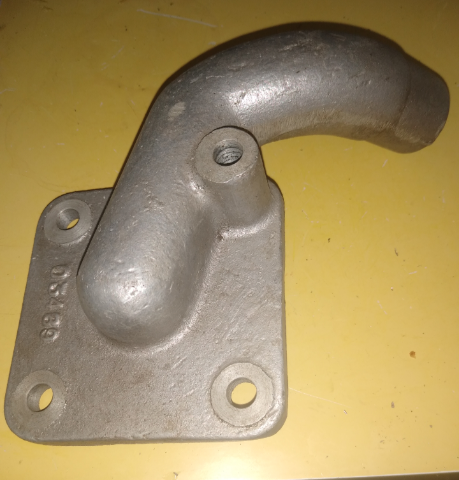

I think the new casting I fitted to the 12 was the only one I had which accommodates this switch, the others are plain unfortunately. The closing plate is a different part number for the 6 cylinder cars compared to the fours,from 1939 onwards for the 16 and 20 so that may be a possibility as to where a difference has lain. As I have replaced the 1946 14's casting too, I am hoping never to have to replace either again hence the lack of new ones in the cupboard to photograph. However, this is a brand new original 03489 for the pre war cars :
so that one incorporates the heater pipe and the type previous to that is plain with no pipe.
