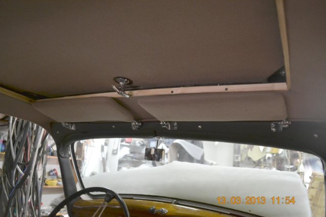

does anyone know how to remove the steel sun roof on my 39 rover 10?

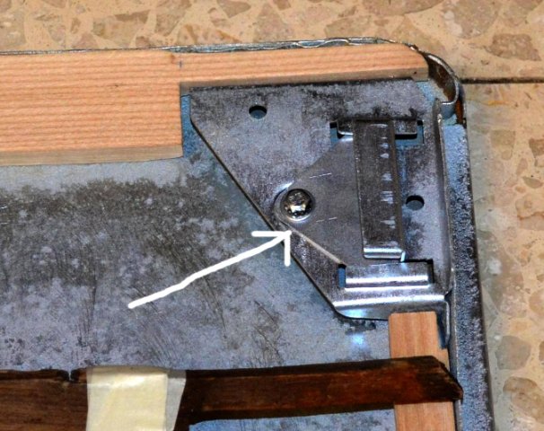

Do you see the dark triangles at the front of the moving part of the roof? (usually it is covered). Move the cover aside, You will find a 2BA screws, undo them. That's all.

Many thanks for the replies, I've seen the screws and |I'll give it a go. There's a lot of wind noise from the roof I want to see if anything is wrong and also check all the drain ways.
