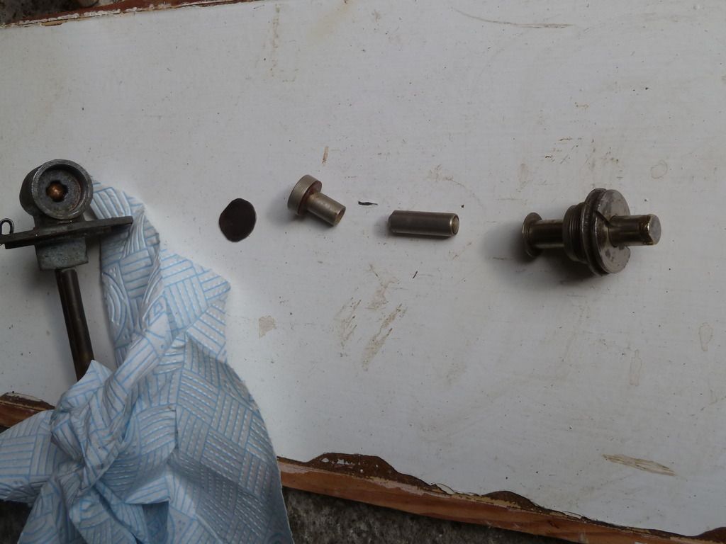

Post by RobHomewood » Thu Mar 31, 2016 12:36 pm
I am trying to refurbish my fuel tank reserve unit (to stop potential air leaks) and having taken it apart (see photo) there does not seem to be any seals or washers in evidence apart from one on the shaft of the piston which moves anyway and wouldnt create a seal. Does anyone know if this is correct or if not where do the seals go and what are they?[imgImage][/img]

Re: P2 and other fuel reserve tank unit
Post by luli » Thu Mar 31, 2016 1:02 pm
As you can see, there is only one fiber ring to seal. I am using also Loxeal on the thread.
Post by luli » Sat Apr 02, 2016 7:25 pm
I have updated the original post and added seals and ball information, and the assembly order. http://wp.me/pXLKy-iO.
Post by RobHomewood » Sat Apr 02, 2016 11:17 pm
Many thanks Luli thats great. Now to find the missing washers etc! The only thing is that the internal dim -9.4mm- of the right hand (fibre?) washer is captioned as the same as the one in the middle but looks different. Is that dim correct?
Post by luli » Sun Apr 03, 2016 5:16 am
You are right. The right washer is 20.2X10 I will correct it in the post.
Post by RobHomewood » Sun Apr 03, 2016 10:47 pm
Now I am really confused Luli! If the middle washer is 16.6 x 9.4 then surely the RH one must be more like 20.4 x 16 not 20 x 10?
Post by luli » Mon Apr 04, 2016 7:55 am
Look carefully at the way it is assembled. It seals the most left item with the most right one. The 10 mm diameter is to keep the ball tunnel open.
