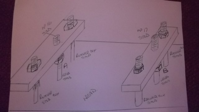

With the problem I`m having removing the head I was wondering if this deqa may help .If the two plates were secured on the thre studs shown,the centre ones being stud s 16 and 17 ,then if the nuts on these two bolts were turned ,to lift the plate up does anyone think it may release the head as there isnt really anything holding it in place ,other then some head adhesive that may have been used,many years ago,Im no artist,before anyone comments Len

Len, your idea of using metal plates and the studs may work but the risk of stripping threads is to be considered, particularly those in the block. Not something I'd want to do.
As Luli said, with just one stud in place at the front corner, sideways pressure applied at one or both rear corners, in turn, should loosen the head. Use a stout piece of timber against the side of the head, long enough to get beyond the bonnet opening, and hit very hard a number of times! Also apply heat with blowlamp around joint and alternate hitting from side to side. If you do this while also giving pressure from below then surely it must give way. Regardless of what has been used to stick it together, the head gasket is only two thin bits of copper with asbestos type material sandwiched between.

Thanks for the suggestion I have never had this before.Ive restored over 30 classic cars ,over the years as a hobby and every one,where the head has had all of the studs removed have just lifted off . Regarding the one short stud on the front corner ,I have fitted two nuts on it and really tried some force to move the stud I dont want to over exert the force,in case the stud snaps I`ll try a long length of timber first after running a heat gun over the head Its a bit awkward as its a friends car,a few miles from where I live.So I cant just turn round and pick up any tool I need I would have thought it would take a fair bit of force,to dtrip the threads on the 3/8 th studs ,but best be safe Thanks again Len
