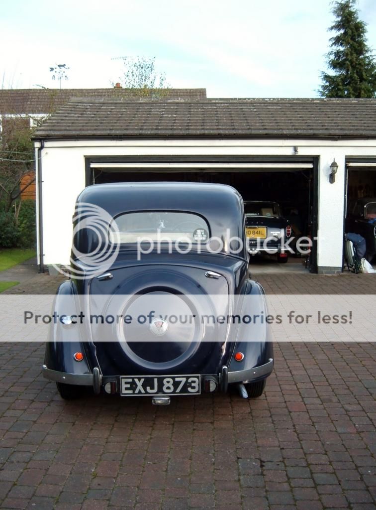

On our 1939 16 I converted the rear D lamps reversing side by putting orange halogen bulbs in with a double filament small globe stop & tail in the red sides. The bulb holders for the stop and tail had to be changed. For the front I just put orange indicator bulbs in the existing wing top side lights and the side lights were fitted into the headlamps which means drilling them :shock:
You can get double conversion kits using miniature halogens (orange & white) from Holdens now though..
I kept the standard column switch and via double pole 3 relays the trafficators also operate.
Note these split D lamps are technically illegal in that the narrow red part has insufficient width area although I have never heard of anyone being stopped to have it measured! It passed all its MOT's till 1996 with its standard dip/pass head light set up too till I converted to double dip bulbs
I fitted a pendant reverse light below the number plate light.
Neat rear indicators can also be fitted using the reverse light with an orange bulb and suitable bracket. Modern high intensity LEDS are too large to fit D lamps and smaller diretional ones are invisible in some twilight/bright sunlight conditions
I was still happy with the brake light intensity so fitted a discrete LED high level strip light in the rear window - better safe than sorry as I had a number of close calls even with the standard single brake light set up
