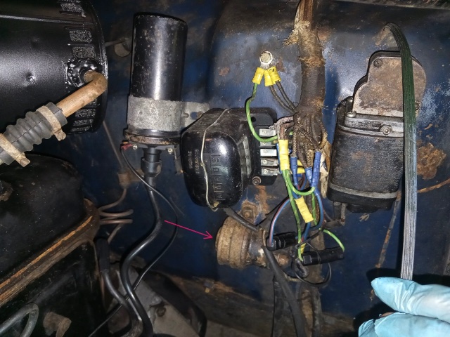

I am attaching a photo of where the solenoid is on a 46/47 car and I think the layout will be similar on your 1937 car. The solenoid is the round black item below the control box. There are three terminals on it. Two are larger, the third is for the starter solenoid. The terminal you want to connect to is the one with two cables going to it, one larger and the other smaller. Before doing this, disconnect the battery. The other larger cable goes to the starter.

And I’ve also found the solenoid (I’m not at the car, but searched through photos I had taken on first visit). So on next visit I can wire between solenoid and coil with a switch somewhere near the instrument panel.
