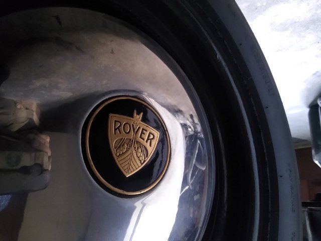

Hello again, Could anyone confirm if the attached picture is correct for the badge on the centre of the hubcaps, i.e. plain brass Rover badge, without black infill in the ROVER, or the ship, and black background / surround with plain brass bezel. I can see variants here and there on the internet and would like to make sure they are correct. If it exists a picture of the original design would be good. Thank you

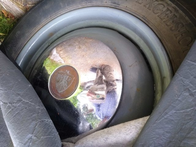

I am hoping to add a fourth picture to the three included with this message. The first is of an "original" badge in that it is (most probably) original to the car and unrestored, so it looks the way they go over the past 80 years.

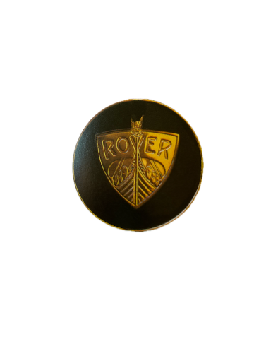

The third is of a badge that should be something like what they were like when they were new. It is on a car very similar to the one on page 80 of Eric Dymock's Rover book and the previous owner had tried to make it as right as he could, well documented, so I would hope it is pretty close to as they were.

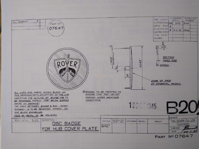

Unfortunately, the parts book just shows a rather unclear drawing but 07647 is the one part number shown, 1939-47, although it continued on beyond the P2 range.

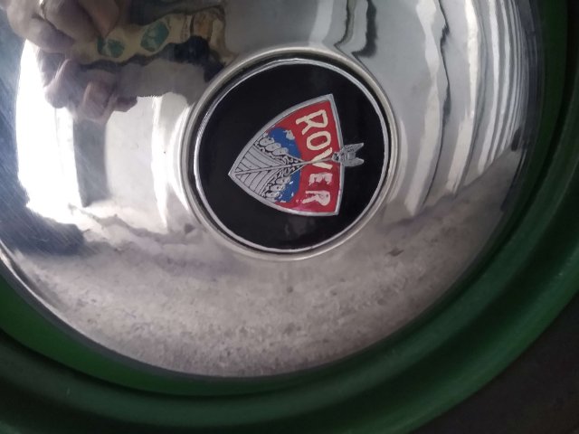

However, I have a third set on another car and they have been extremely nicely painted by someone. Do they look good - yes. Are they correct - no. The car is not on my home ground this minute but when I have a chance to go and see it I will take a photo and add it.

Thank you very much, that's really helpfull. the ones on my vehicle are similar to the third picture but the bezel as also been painted black, which I don't think looks as good. As you will see I have now managed to attach, with the help of a forum member, the picture from Eric Dymock's book.

When you say the black doesn't look good, I would agree that that could be the case if it is gloss black. The black I think it should be is a satin black and that is what I would use, but that's just an opinion. I think it should be a similar black to the dashboard panel. Black is one of the most difficult colours to match or look "factory", there are so many different types. RAL9005 is my shade of choice, usually.

I did promise a picture of the rather more colourfully painted wheel centres, definitely non-original! They would give an artistic person an idea of something else to do in the painting of these.
I also turned up what you asked about in the first place, the original drawing below:
