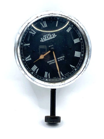

The winding mechnism on the replacement I obtained does indeed protrude from 6 or 7 o'clock (see attached picture), so looks to the right part and also has the blue transparent strip.

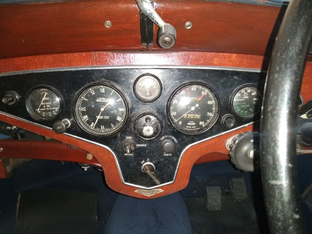

I think all my instruments are original as the bezels are not chrome but dulled brass (see other picture), presumably because the chrome has worn off. The replacement clock has a chrome bezel, so when I get the old clock out I may look to chenge the bezels over, although they seem to be more that just the bezel but the casing.

Good, I was going to change my original reply as I remembered that when describing how the shaft comes off, that only applies to the later designs. The earlier models have the winder going straight up into the back of the casing which is held on by small countersunk screws. Chrome bezels were fitted certainly up to at least 1935 but from about (late?) 1936 onwards, a matt - or maybe satin?- black finish was applied. The 36 parts catalogue appears to show chrome bezels but the 37 one shows black bezels. The earlier clocks (Parallel sided case) don't have a separate bezel, it's a metal cover about 2 inches or so long with the glass held in the one end and the countersunk small screws I've mentioned above at the other.

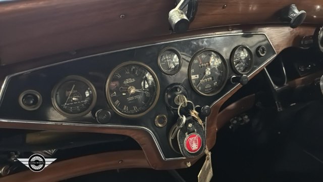

I have just seen your dashboard picture ! Were I a gambling person, which I'm not, I would bet on your existing clock having a quartz mechanism which explains why there's no winding handle because the clock work will be long gone. The characteristic tick tick tick tick of the mechanical clock is much nicer than the "scrunch scrunch" of quartz movements, though you can get quieter ones now. The dual gauge incorporating the water temperature can be handy but they didn't come until later as standard although they were an extra cost option so it would be worth looking to see if yours exactly matches the petrol gauge and speedometer. Of the cars I have, your dashboard is most similar to my 1938 14 . If I have managed to attach a picture, it is only as an illustration because the car is one of the "hacks" and not an example of how anything should be.

Many thanks again. So it looks like the replacement clock I have is an earlier 35/36 type clock as it does not have a removable bezel but the 2" sort of depth casing incorporating the bezel with the countersunk screws. It is good to know that the bezels should be black, as I could therefore paint all my bezels black, including the chrome on the new replacement clock.
The dual temp/water gauge certainly matches all the other gauges, so I imagine it is potentially original fitment....but who knows after 89 years!
