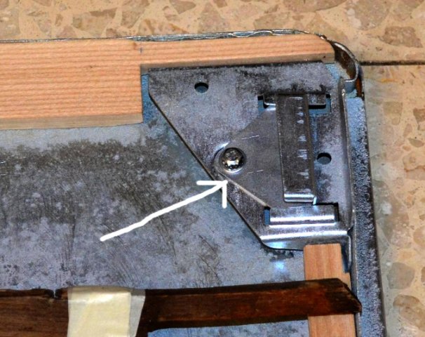

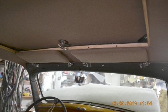

Do you see the dark triangles at the front of the moving part of the roof? (usually it is covered). Move the cover aside, You will find a 2BA screws, undo them. That's all.
