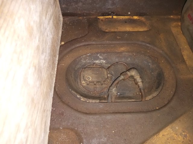

The petrol gauge on a 1937 p2 is not working. When the ignition is switched on the needle moves very slightly ... but then stays there irrespective of amount of fuel in the tank.
I don't have a wiring diagram - and both manuals are out of stock.
How do I determine whether it's the gauge, wiring, or sender unit.
[ :roll: attachment=0]20241211_130028.jpg[/attachment]

I would guess at a stuck sender. You can check it before taking it out by disconnecting the cable at the right hand end of the sender unit and connecting that cable to a good earth (clean metal). The gauge should show empty or full when connected or disconnected. The arms stick at the pivot point and it can take quite a bit of penetrating oil and gentle pressure to get them to move without the arm breaking in the casting but it is worth saving them. If you undo the 6 screws holding the sender unit in, again carefully, because they can snap so use a sharp screwdriver that fits well and unscrew a turn or two, apply oil and then tighten then slacken, keep doing this until the screw comes out nicely. Of course, there is another obvious way to test the gauge on these cars and that is to press the oil level button and see what reading it shows!!
Once you have the sender unit out, check that the float is not leaking. If it is, new plastic ones can be bought to replace the originals. Once moving well, check the wiper arms in the resistance unit are making contact with the windings (remove four screws in the top cover, try not to break the gasket if possible or make a new one) and then if you earth the body of the unit to the car, and reconnect the cable to it , by moving the float up and down, the gauge should work. If is doesn't, it's probably wiring or the gauge but at the stage you are at, the sender unit would seem the place to start. There are compatibility issues between newer gauges and senders, and older gauges and senders. Later petrol gauges from the 60s onwards use a power supply that has been through a voltage stabiliser so the reading isn't instantaneous as on these but "smoothed out". Should that route be suggested to you because of components on the car that are beyond repair (we'll hope not) the one thing to note is that the majority of voltage stabilisers are negative earth but they are also made specifically for positive earth vehicles so just something to be aware of.
