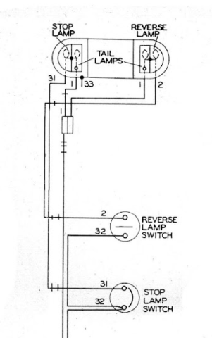

Where can I find the ‘Reverse Lamp Switch’ on the 12 HP Tourer?
Reverse Lamp Switch circuit 12 HP.png (80.61 KiB) Viewed 12542 times
This switch is shown in the wiring diagram of the 12 HP, but it is not connected on my 1948 Tourer.
I would like to retrofit it.

On my 6 Cyl P2 DHC its on the side of the gearbox, I imagine its the same on the 12HP, Accessible from inside the cabin by taking the gearbox cover off.
Re: Reverse Lamp Switch for 12 HP Tourer
Post by RobHomewood » Sat Sep 28, 2024 11:08 am
Sorry to be more accurate I should have said the reverse light switch is on the side (nearside) of the gearbox remote arm casing rather than the gearbox proper.
