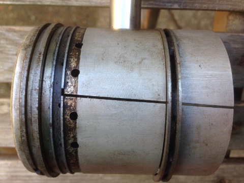

I have no experience of the 14 engine but the 12 has split skirt rings also. Attached is a picture of a piston removed from my Tourer. Is this similar to yours and, if so, did you refit the pistons with the rings in the same order? I ask because it appears that the two oil control rings are different in function but possible to place in wrong order or upside down. Also, I suspect that the upper of these two rings has a duel purpose for compression and oil control so possibly fitted at 120 degrees to compression rings, but that is a pure guess on my part.
Good to discount the possibility of the rings and hope this helps.

Hello Tony,
I have a set nos 14 hp pistons witch are the same split skirt pistons as the one in your picture.
Only the oil rings are opposite installed. So we can be sure that the oil rings have no top side .
