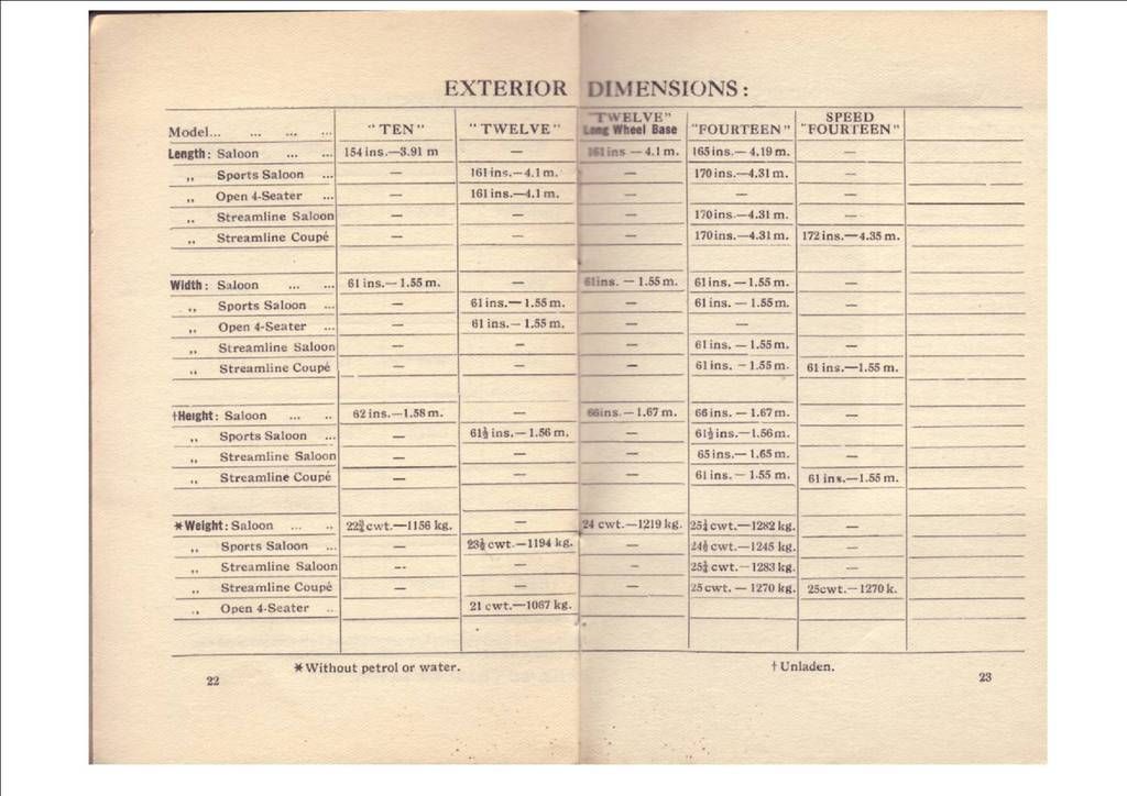

As regards weight of the tourer compared with saloons, please see attached extract from the 1936 salesman's booklet. Note the length of the sports saloon and 4 seat tourer.

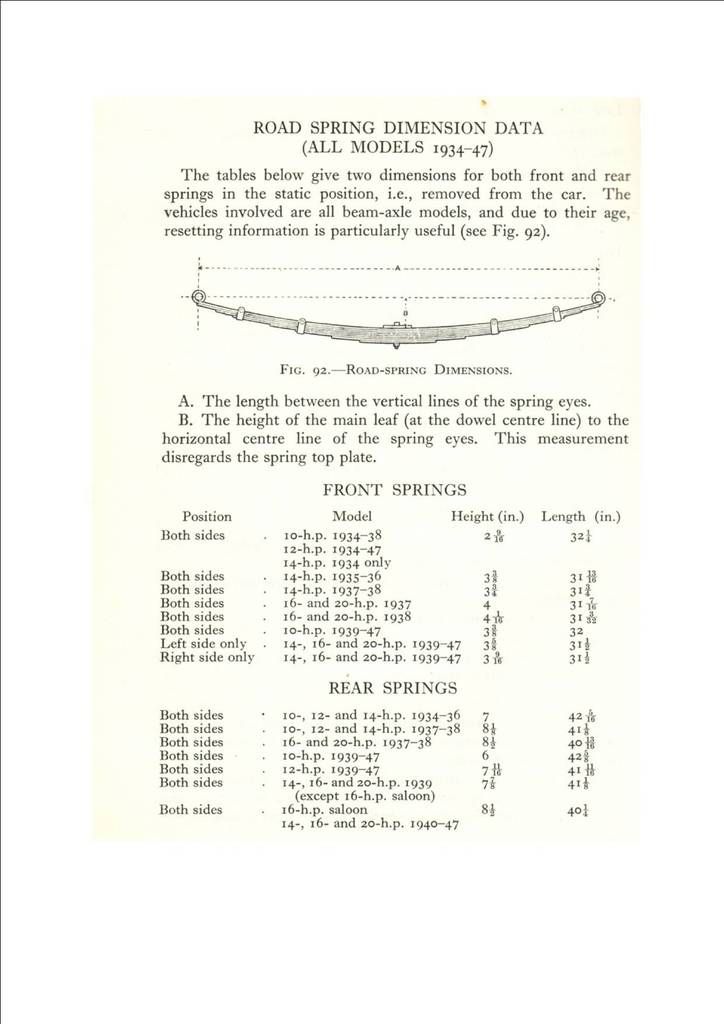

The setting information for rear springs taken from a 1947 service newsletter is:-
The individual year parts lists don't have a specific reference to tourers, but show the same part numbers for all 12hp body styles (except the saloon). 14 hp sports saloons also have the same springs. This seems distinctly odd given the lighter weight of the 12 Tourer.

Mike, this is really useful information. Given that there is a 200Kg difference in weight between 12T and 14, but the same springs shown, the Tourer must have been overlooked in the later document. I cannot imagine the current spring manufacturers will have more detailed information, which explains why both Rod and I find ourselves with the wrong springs. However, the data will allow me to check that my springs are set to the correct measurements, which is a great starting point. Thanks.
