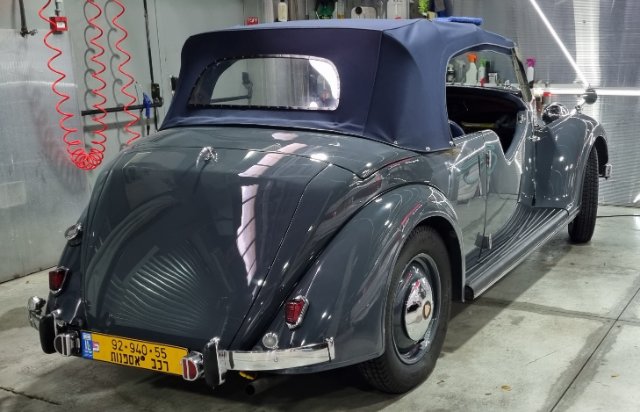

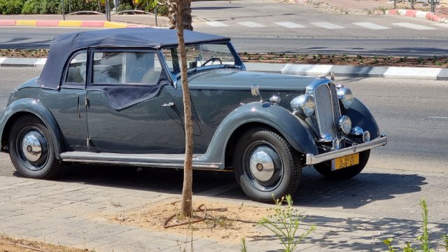

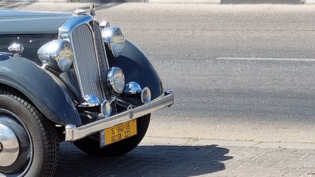

Post by luli » Sun Nov 28, 2021 7:25 pm
Some pictures of my 1947 12HP tourer with Excelsior 17R550 radials:

Post by TonyG » Mon Nov 29, 2021 8:40 am
Luli,
Great pictures of your car! I’ve been hunting for radial tyres to fit my Tourer. Some like yours would be fine but I cannot find any for my 18” rims. Currently I have 550x18 Blockleys, which are hardly worn but they are just a bit too wide and can rub the inner arches on the rear if cornering and hit a bump, which happens often on our dreadful roads! However, unless I can find some radials, I’m reluctant to change them as the only option is a regular crossply. Blockleys don’t make a 475/500 and the 450 they do is too small for the width of my wire rims. These are crossply but made to a very high standard and speed rating. Hence why I was looking at the space saver tyres to replace them, which do come in suitable sizes but only as tubeless.
So, if anyone has used these space savers successfully with tubes, I’d like to know. Thanks.
