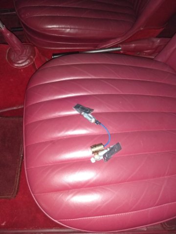

For the best part of probably 15 years or so, I've been carrying one of the attached (picture) in each car with points. I buy a job lot of condensers and fit them up with leads and crocodile clips and put one on each car. If you suspect a condenser is faulty, no need to carry out potentially life threatening work at the roadside, just attach one clip to either the coil end or distributor end of the lead between the coil and distributor, and an earth. If the condenser is failing or failed, that will do until you can effect more permanent repairs. They are particularly handy for the soldered on type of condenser in the postwar car.
It is difficult to test a condenser at home other than by substitution and this is a very straightforward way of so doing.

I can understand the crocodile clips and the piece of wire soldered onto it but what is the other bit, looks like a bulb holder but I guess it is something else..

There is no bulbholder and there is no solder. There is a new (any type) surplus condenser off anything that comes in quantity at reasonable cost and it's a simple case of attaching any terminals to it that make a secure connection to two crocodile clips. Nothing more. Unfortunately the poor resolution of photos here means I can't show the pictures with more pixels.
