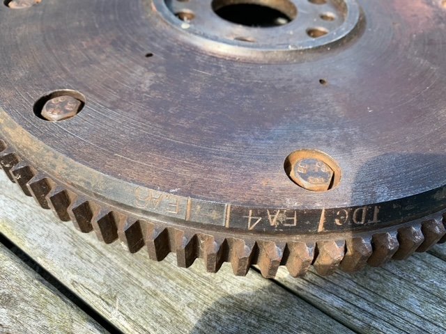

I will try and have another look for the markings!
Posts: 315
Re: Frustration! Overheating.
Post by David2021 » Sat Jun 18, 2022 10:16 am
Found the marks...seems to be right! Discovered the distributor was from a Wolseley 8 - it is the same model distributor, but with totally different characteristics...It's serial number is one different to the Rover...! ). Amazingly found a new Lucas Rebuild (1958) on Fleabay & fitted it yesterday. Frustratingly the Radiator rebuild is behind schedule so I can't run the car...it should be done today.....Still planning to go to the Continent on Wednesday..

Got the radiator back on Saturday.put it on& the filler next was 1/2" too far forward..... took it back & Paul resoldered it back ...this time I took the shell and bracket! Perfect. Reset the ignition ,, much better. The new distributor is an unused Lucas B90 rebuild ( in fact I think it is brand new).Much popping on overrun...mixture ok, but spraying the carb flange with WD40 identified the problem....bad carb flange gaskets and a cracked heat (paxolin?) Spacer. I had nether! So made a couple of paper gaskets and araldited the spacer. Problem solved. I now had a cool smooth running motor. Due to leave in 12 hours....what could possibly go wrong? !
Packed the cars (the other th MG ZA) & set off for Dover. Minor panic when the petrol pump isolator switch got knocked, then on the M40 after Stokenchurch, a strong smell of petrol. All over the very hot manifolds. Stuck needle valve? No ....valve had unscrewed itself!. Then a clear run to the Tunnel &France .No overheating, running on nor popping and banging. Now in Luxembourg. ..thunder and lightning with downpours!
