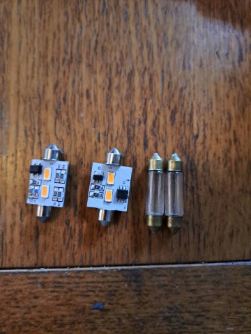

Hello,
I bought a set flashing leds for the trafficators from ebay.
I am very pleased with them
https://www.ebay.nl/itm/183773051711
These are 36mm
These offered for VW cars are 32mm and have single leds.
With kind regards Dammis
Double Dutch
Posts: 6
Joined: Mon Oct 10, 2011 1:03 am
Re: indicators
Post by Double Dutch » Tue Jul 29, 2025 6:51 pm
Flashing trafficator leds
