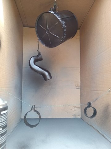

While waiting for other things to be ready to bolt back, I thought I would re-paint the air filter.
What paint finished did it originally have, or would look good/right now?
Mat black, crackle finish?

Post by GOY189 » Sat Mar 29, 2025 12:48 am
Gloss Black would be appropriate.

Before I paint it, i thought I would clean it.
Is it take-apart-able?
It look like it's not.
How best to clean it?
Any guidance much appreciate.
Does it have an oil bath? ... that needs refilling.

Post by 47p2 » Sat Mar 29, 2025 10:18 pm
The unit does not come apart, it's not an oil bath type. You need to clean the entire canister using a non volatile parts cleaner solution then allow it to dry completely before applying a heavy oil to the mesh. I've used Gunk engine cleaner and KN filter oil with good results

Post by P27 » Mon Mar 31, 2025 9:37 pm
I started to clean it, but it's in very poor state with several holes
Is there any chance of getting a replacement?

Post by P27 » Fri Apr 04, 2025 12:15 pm
As a temporary fix, I filled the holes with chemical metal (more successfully than I had guessed :) and repainted it all.
I read that in use it gets oil vapour from the engine. But how should I first fill/inject it with some oil?
Would 'Duck Oil' from an aerosol can (with the thin pipe/nozzel) be any good?

Post by SHyslop » Fri Apr 04, 2025 12:21 pm
Usually engine oil (30 or 20/50) . The idea is the same as a K & N filter, the tackiness of the oil traps particles in the filter material until it is cleaned out.
