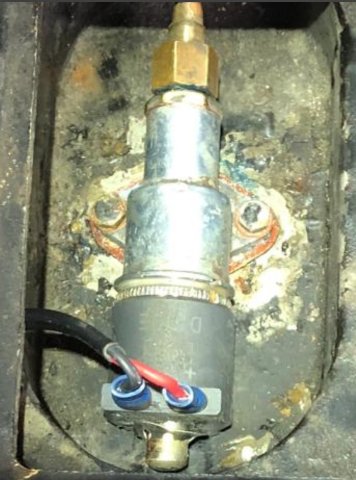

I am resurrecting this thread as I have an easy cheap fix for the frequently experienced problem of failing fuel reserve valves. I have an old Aston which uses the same system as Rovers. I bought a job lot of failed P4 valves for experimentation. A short pipe draws fuel normally. When the fuel level falls below the short fuel pipe you ‘run out’ as the pipe is sucking air. You then pull the reserve switch which illuminates the dash warning light and energises a solenoid. This pushes a ball valve against the spring which normally holds the ball off the top end of the short pipe. This forces the ball against the short pipe orifice closing it off and restores suction from the pump. This allows fuel to be drawn through the longer fuel pipe.
All of the valves I bought suffered from the same problem as mine. The wiring to the solenoid – a 12V electromagnet – had perished and disintegrated. They can be fixed with great care and skill but it involves considerable risk as the insulation on these old hand wound coils is poor and the unit operates adjacent to the fuel tank. Even if yours has not yet failed it is likely that the wiring to the coil and the insulation will be very fragile.
I therefore looked for a modern properly sealed and insulated solenoid that was of a similar rating and of a size to fit over the tube containing the actuator. I found this on eBay for under £20 - https://ebay.us/m/FOW2tb . It is rated at 11 Watts and 12VDC, and so operates at just under 1 Amp.
To fit the new solenoid, you unscrew the cable clip and twist off the original dust cover with a vice grip, pulling off the coil with it. Slide the new solenoid over the actuator shaft. Connect the positive and negative wires to the spade terminals which are marked.
Here it is fitted to my unit and working fine.
It should now click with a 12V battery and when you blow down the short fuel pipe you can feel it shut off. You can secure it in place with a large star washer.
If it doesn’t click, unscrew the knurled ring holding the actuator shaft, using a vice grip. Clean it out with carb cleaner and ensure the actuator and ball move freely. Replace the sealing washer with similar and reassemble and test again. Eventually it should work, hopefully. Good Luck.

Re: Rewinding a fuel reserve solenoid
Posted: Sat Feb 14, 2026 9:45 am
I know this is rather late to the party but I did want to thank astonchap for his reply and pointing me to a replacement solenoid. I bought one and it does indeed work so I am very pleased with that indeed. Unfortunately, the precise model had gone off eBay by the time I looked and now, so has the one I bought too but looking under :
"Magnetic Electric Coil 12 V-DC 11 W for LPG Autogas "should turn one up.
The one slight problem I saw with it was that the solenoid became quite warm when on and I could see this maybe becoming an issue if the reserve was either left on for a while (a whole 25 miles on that gallon of petrol!) or inadvertently.
However, I think I have the solution and that is to reduce the voltage by fitting a coil ballast resistor (possible cheapest UK supply being H Bowers off eBay at under £7 delivered) and this seems to have worked, on the bench at any rate. It looks as if the solenoid works perfectly well with 9/10 volts.
