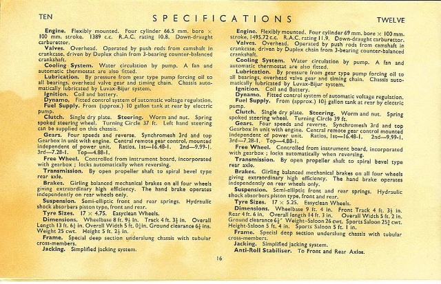

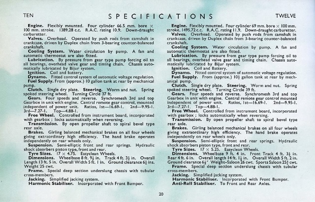

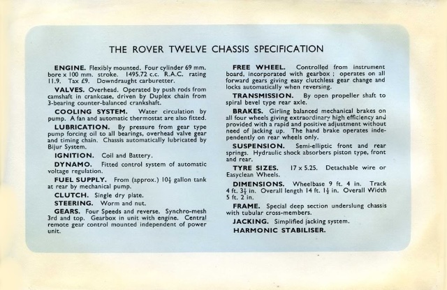

Tyre size for the Twelve is 17 X 5.25.
1947 Brochure page below
1946 Brochure page below
1939 Brochure page below
