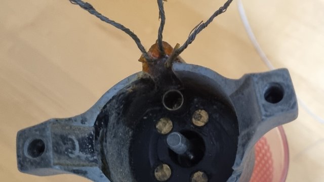

The wires are embedded using some resin. You can expose them using a small sharp screwdriver, and re cast with epoxy. See picture

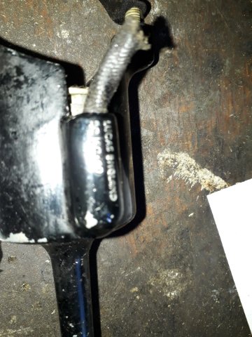

I have a spare trafficator switch but unfortunately I dont know which year it is. My Lucas catalogue only goes up to 1939 so it may be later. The number on it is difficult to make out but is something like 3014G/40. That doesnt quite fit with the catalogue numbers I have aroung 35/37 though. I attach photos in case you can recognise it. Please let me know.

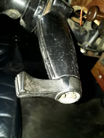

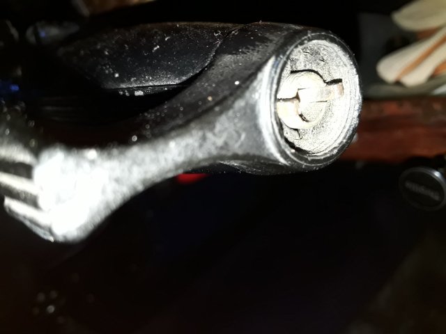

In the same vein I am missing a threaded cap to my 39 trafficator stalk but dont know what it should look like so difficult to describe. I attach a photo of the location. I cant find a separate reference number in the catalogue.

Thank you Rob,
I have replied to you on my other post in the "Wilks' cars P1 and P2, thats cars up to 1947"
section of this forum.
Your switch is the type I am looking for.
I will message you.
Paul

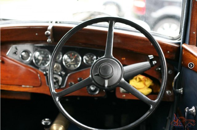

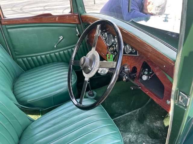

attached are two photos which I think depict the type of trafficator stalk you have.
I have also seen similar with just a blank end cap as well.
I will continue to investigate.

Thanks for the new images. That certainly looks like the same trafficator stalk but it appears to have an red dome on the cap as if for a lamp and there is no wiring at all in my stalk. There is no gurantee that my stalk is the correct one of course. Could you tell me what model and year the photos are from? I'm guessing earlier than mine because of the central windscreen winder but I have not seen a door on the glove compartment before.Many thanks

Hi Rob
the photos are from a 1935 Rover 14.
https://car-from-uk.com/sale.php?id=84351&country=uk
However I think the repeater lamp on the end is an addition and non-standard.
The glove compartment cover again I think has been added.
Paul

I think the glove compartment cover is correct for a 14. The 10 doesn't have a cover , I'd need to check more carefully about the 12 but the 14 definitely does, presumably one of the items to warrant the higher price.
