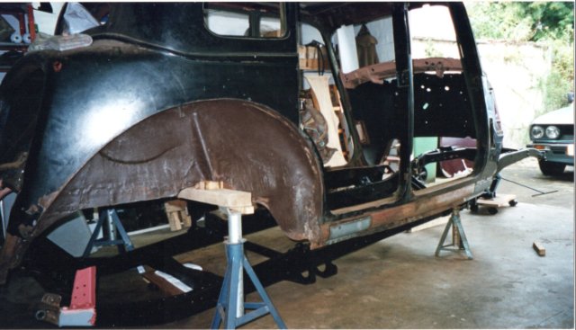

OK so here's the update.
All bolts removed and still little or no movement. I jacked up the body via the door frames (one side at a time)so the chassis was hanging from the body and then a few smart wallops with a hammer and off it came. Repeat on the other side. Only moved by about half an inch but at least it was moving. All I need is about four strong young men! But... onwards and upwards.

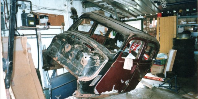

Keep at it, Adrian! I did my body/chassis swop single-handed - but it did take quite a few jacks, axle-stands, bits of wood, a certain amount of swearing and the odd mishap!
DaveM
