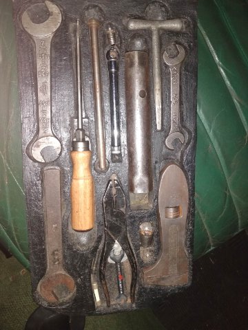

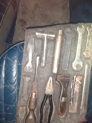

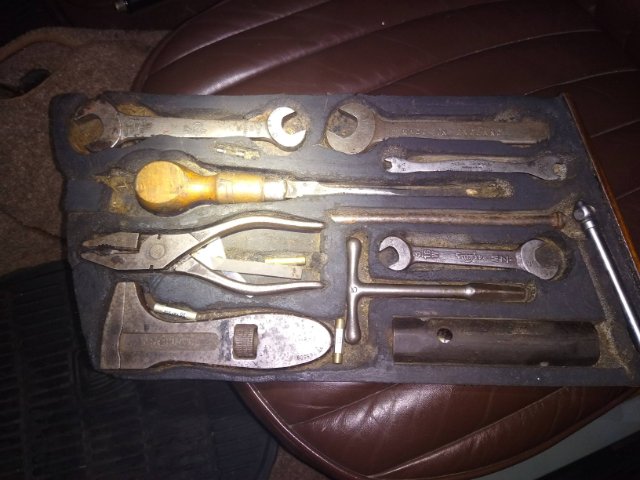

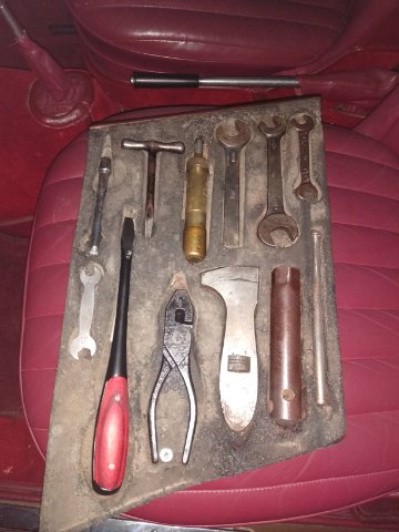

Dear David,

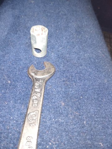

I hadn't noticed this so my apologies for being late to the party. Rather than witter too much, I am enclosing some photos ( not intended to be examples of what's right or should be) but the bits I should write are :
1) I only have one tray with the small box spanner in it and it is 3/16W. I have been half looking for more but with no size or makers name on it, they may be a bit hard to track down.
2) Snail Brand was, to the best of my knowledge, the only firm that supplied spanners. Later Snail Brand spanners, and those of some other makes, don't have the jaws set at an angle which match the recesses.
3) I believe that the Snail Brand spanners with just one size marked on each end were correct for 1946 as these came with a one father/daughter owned car and were more likely to have been original to the car. The sequence seems to be : dual markings (BSF/BSW)pre war, single markings early post war, straight jaws and text SNAIL BRAND, late 40s early 50s.
4) Correct screwdrivers (with decent tips) are difficult to find ! The handles should have flat sides, not all rounded and they are not the "Perfect" pattern screwdrivers made by Clay.
5) The pliers are by TW, who made Superslim

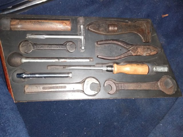

6) I have included a picture of a P1 toolkit which preceded the under dash tray. Spanners marked "Rover" (not shown in these pictures) look to be older than 1934 as they are a different size to the spaces.
7) You might find this website:
https://www.classic-british-car-jacks.uk/
of interest. The 14s and 16s just pre and post war had a hydraulic jack and the 10s and 12s had the wind up ones. The 1939 handbook says to wind up the jack "with the handle provided" . I have just read in James Taylor's "Rover cars of the 1930s" that the Stevenson jack, in 1937-40, was raised by using a box spanner or the wheelbrace. Whether this continued postwar it doesn't say. While that isn't what I would have guessed , there it is.(P.145).
If anything in this raises questions, good! I may not know the answer but someone else might.
