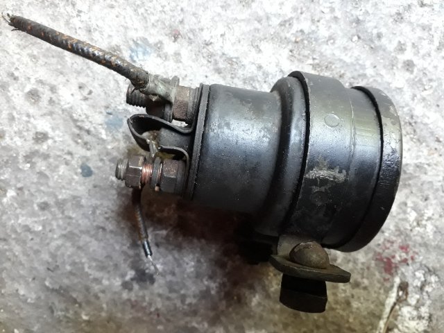

I am looking for a replacement starter solenoid for my '39 P2 but I cannot find any reference for it either in the data or on the unit. The starter is a Lucas 418G. The nearest lookalike I can see on line is a Lucas SRB316 - in this case with a push button - but I dont have any technical spec. Are these pretty well universal electrically? Any help appreciated

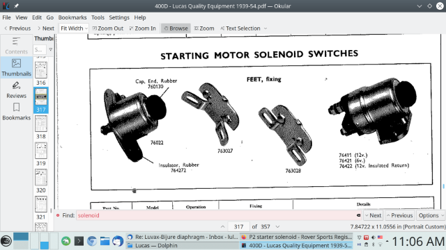

Lucas p.n. is 760080. I am surprised - this item never brake.

Later p.n.

Thanks for your reply Luli. I am not sure that it is the solenoid but I have checked all the connections under the bonnet and they feel good. The battery was fully charged at 13.8V at the start and only droppped to 12.1V after 2 days of testing so I dont think that is implicated. I tested the starter off the car by connecting direct to the battery and it spun. However on the car all I get is a quick whir and a clunk which I think is the bendix going forward and stopping. All the dash dials stop with the current take. It does not turn the engine anyway even with the plugs out. My spare starter doesnt even seem to spin so that is no help.
Getting the starter refurbished is going to take 4-6 weeks and I want to try any other alternatives first hence thinking about the solenoid. How do you test the solenoid? I have a spare of unknown quality but with no ID visible either.
