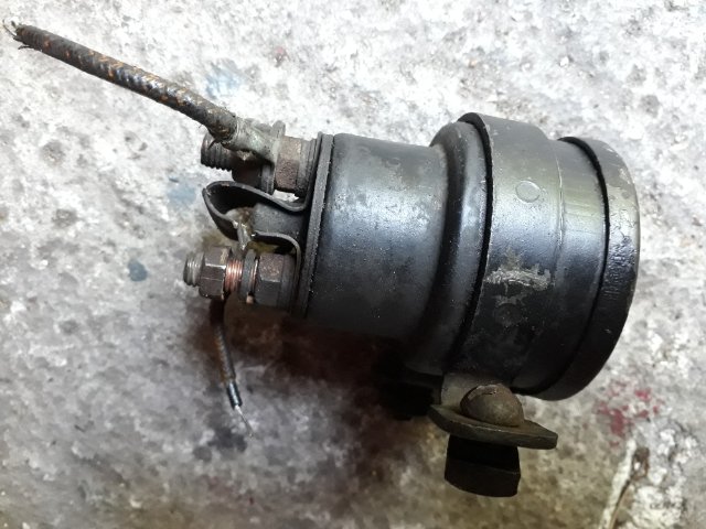

I am looking for a replacement starter solenoid for my '39 P2 but I cannot find any reference for it either in the data or on the unit. The starter is a Lucas 418G. The nearest lookalike I can see on line is a Lucas SRB316 - in this case with a push button - but I dont have any technical spec. Are these pretty well universal electrically? Any help appreciated

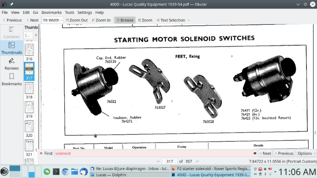

Lucas p.n. is 760080. I am surprised - this item never brake.

Later p.n.

Getting the starter refurbished is going to take 4-6 weeks and I want to try any other alternatives first hence thinking about the solenoid. How do you test the solenoid? I have a spare of unknown quality but with no ID visible either.
