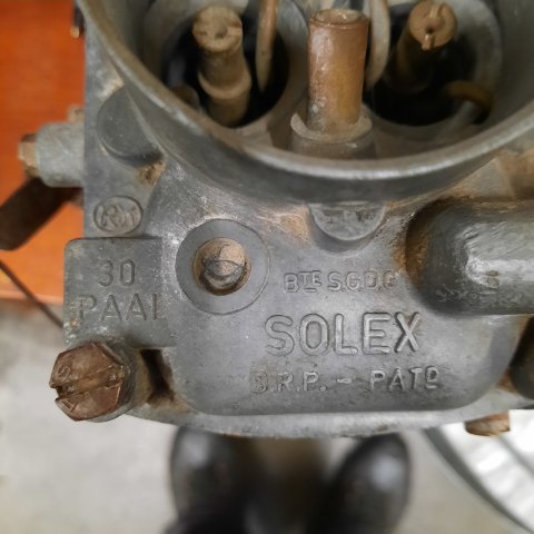

I have a solex 30 paai carburetor that's on my rover p3. I hear mention of people having a solex 30 paai 2 carb on there's. Is there a difference? I haven't been able to find any good photos of the stock carb. Mine looks just like one on a Mercedes 220. Trying to establish what rebuild kit that's needed. Thank you for your help.

Here is a picture of the carburetor.

The Solex should have another identifying number stamped, not cast, on the body somewhere I think. (this would identify it as for a particular Rover and not for e.g Mercedes 220.
You may pick up a service kit marked for 30PAA1 in a Solex spares envelope at an autojumble, they made generic kits that fitted several cars using the same carburettor and these included gaskets & O rings etc, but not jets

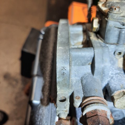

K4 is stamped I found another k stamped on the bottom.

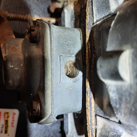

Then looks like a 92 on the left and a 94 on the right. That's all I have stamped on this unit.

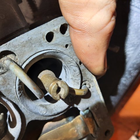

Also found 26-30R-24 on the inner carb

There is a wealth of good information on the 30 FAI, 30 PAAI and 30FAAI/FFIA in the P2 Workshop manual. This includes extracts from the Solex trade leaflet on tuning, troubleshooting etc.
The P2 Workshop Manual Chart refers also to the P3 60 being fitted with Solex 32PB1-2 #S1491 and the P3 75 with Solex 30PAAI-2.
The 75 Solex has jets etc as follows
Main 97.5
Pilot 60
Pilot Air Bleed 120
Starter Petrol 135
Starter Air 5
Correction 240
Economy 60
Accelerator 65
Choke tube 21 NOTE (this is the part in your picture marked 26-30R-24 ….this may suggest a 24mm not 21mm choke perhaps!) So is your carb the original? No Rovers in the Manual have a 24mm choke!
When I was looking for Solex Jets for my 1947 12hp Burlen did not have any remanufactured ones.
the 30PAAI unit is described as : A much more common unit, which was fitted to a number of cars, several foreign (ugh!), as well as in other forms such as AAPI on Ford V8's.
The 30PAAI was offered apparently as a replacement for the 30FFAI when it became obsolete.
Just to make it even more confusing the Workshop Manual says that Solex (!) sometimes supplied (incorrectly) 30PAAI-2 as a replacement for a P2 16hp although it was actually specified for a P3 75 Their catalogue confused the 16hp rated P3 75 with the earlier 16hp model!
The "other number" that I referred to would have been like an S-891 (14hp 40-47) or S-1491 (P3 60) or whatever, but there is no reference to an S- number in the Workshop Manual for several cars, so perhaps Solex had stopped marking them, or the numbers are lost in the mists of time.
