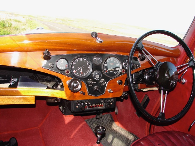

Just curious how common was the tube radio in the p3? I have yet to test mine. Are parts still available if I need something? I have a couple suitcase style tube testers but are there known other parts that go bad with age?

If you want to use the radio it's better taking it to a specialist who will remove the valve interior which by now the wires will be crusty and dangerous and have them fit digital/FM tuner to which you can have Bluetooth, MP3 etc. This will keep the original look to the exterior. I
I had an FM board and an MP3 lead fitted to my Radiomobile in the P2 (no Bluetooth or digital board back then)

I agree with 47p2 and wonder if there are steel AM stations broadcasting?
However, If that's what you want these radios can be repaired and play. Parts are available.
