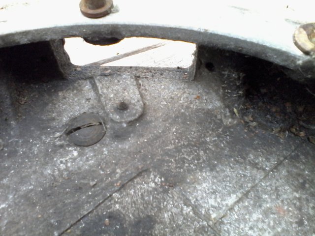

Returning to Graham's question, the timing pointer on P2 engines is a cone-pointed screw which protrudes into the flywheel housing from the cylinder block side - and isn't all that obvious. It looks like your P3 might be the same. The photo the inside view on a loose housing.
Hopes this helps, Dave
