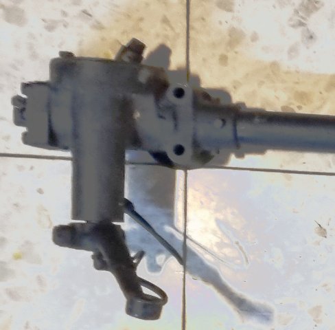

Re: rover 10 p2 steering
Posted: Mon May 18, 2026 5:07 pm
The distance - hole centre to hole centre - is 4-3/4 inches.The drop arm is curved. As for orientation - see picture.
