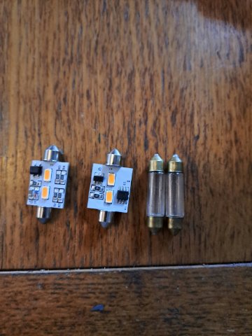

Hello,
I bought a set flashing leds for the trafficators from ebay.
I am very pleased with them
https://www.ebay.nl/itm/183773051711
These are 36mm
These offered for VW cars are 32mm and have single leds.
With kind regards Dammis

by Double Dutch
Flashing trafficator leds
