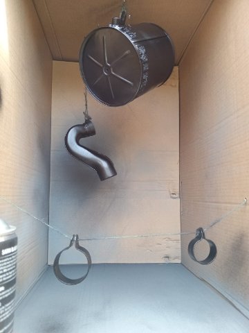

As a temporary fix, I filled the holes with chemical metal (more successfully than I had guessed
and repainted it all.
