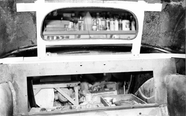

I'm unsure what exact wood is on the prewar cars but the post war cars have wooden floors which when renewed are done with ¾” marine plywood, the trim pieces will be on a fibre board similar to hardboard which can be bent into shape by soaking in water then shaped as required. The sunroof has a timber frame and the rear window between the head cloth and metalwork also has a timber frame.
Rear window timber
