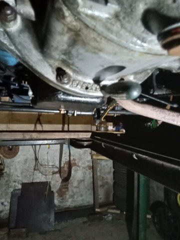

Just to clarify, the bottom of the gearbox housing does have 2 holes in it, with a screwdriver you can push from the back towards the front aout 2 1/2 inches in so I assume to the front of the casing.
Attached is a photo with a screwdriver in one of the holes, looking towards the front of the car.

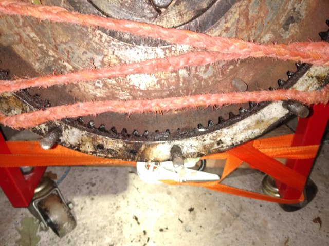

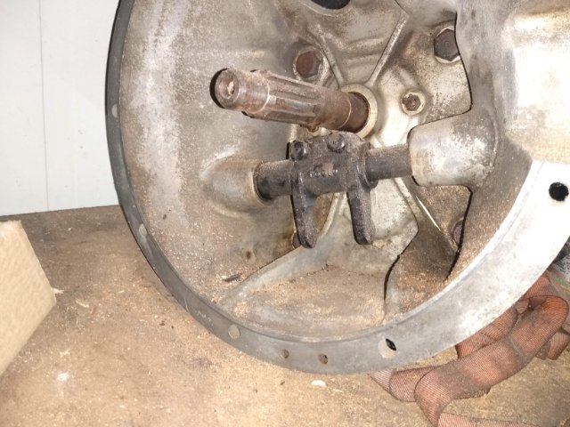

I see, I had ruled those out but have had a look just to confirm. I've taken a couple of photos of a bellhousing and also the back of an engine and you'll see they give no access to the flywheel. I'm sorry the news on that front isn't better. In case you wonder what I was maybe looking for, on a 1934 Austin 12/4, the bellhousing at the bottom is almost skeletal. You could do quite a bit to a clutch through the two holes in it which are like two pie slice shaped pieces about 4 inches at the curved end 3 inches long. The first time I saw one I thought someone had cut chunks out until I realised they were meant to be, so I didn't want to entirely rule out that you had something similar !
Re: Car shaking setting off
Ah well, clutch repair it is then... what could possibly go wrong..
