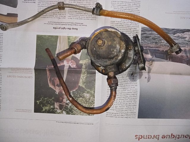

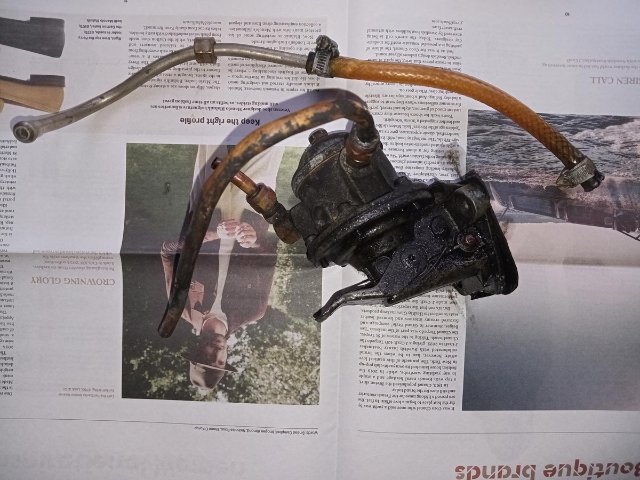

I've removed the AC pump and it's a Type U - so has the original has been replaced at some time?
Are Type U OK for this engine - The engine number is: 811721*. (e.g. the 'throw' of the cam/lever is not too large), or the spring pressure too great?
Are originals pumps still obtainable? Or should we repair the existing?
https://www.flexolite.co.uk/products/fp ... ent-to-bd2
Another SU forum (austin seven) mentions part Nos on the pump, and on the arm/lever - where should I look?
Any other info on this engine 811721 gratefully accepted.

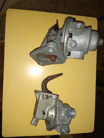

It'll probably have been replaced, particularly as someone has been at the pipework already. The delivery pressure for these should be 1 3/4 lbs. This is the lowest for an AC pump and they can go up to 5 lbs(Buick) but probably the most common ones, for an Austin , are 2 1/4lbs.The spring under the diaphragm controls this. There's usually a number on the arm but these Rover pumps have a completely different size and shape of actuating arm to many of the other, including Austins. Austin used the same type of lever on most of their cars from 1933 until the late 40s at least and so that design of arm is one many people are familiar with. Rileys had a slightly shorter straightish arm that stuck straight out from the pump and 60s Triumphs had an arm which is probably the same as the one I am showing in the photo. The prewar Rover design has zero in common with any of these !
I am attaching a photo of what I believe to be an original new T Type pump for a Rover 10/12. It came with what used to be Derek Brown's 10 so that should be decent provenance. The other is a Type D pump which has something closer to what many would recognise as a "normal" actuating arm. As you will see, the Rover type of arm is a completely different design and I don't think there is room on the Rover type for the sort of numbering usually cast into the other type of arm. The one on this pump is, by the way, 1524165 so that maybe gives you an idea of the size of the lettering.
The hard part to know is whether your pump will have been fitted as a "new from AC" Rover specific pump or whether it has been for something else and someone has swapped the necessary bits over to "Roverise" it. I would say it has been pretty common practice in recent years to do the latter because this design of pump specifically for these cars has been obsolete for quite a long time.
You can test the pressure with a kit AC used to make but if you think the car was working at some time in the past with what is on it then there's no reason why it shouldn't do so again. The problem with newer manufacture pumps which look superficially similar is that the threads for the pipe fittings are different now and unless you have ready access to a selection of threaded couplings it can be an awkward job marrying Enots fittings to metric or SAE depending on the date of manufacture.
It would be worthwhile blowing down the pipe to the tank and making sure that the pipes are unobstructed. I'm not sure when they started fitting a gauze to the pick up pipe but if there isn't one, watch out for largish pieces of tank debris being sucked to the intake. There's also the question of the reserve changeover tap......?
