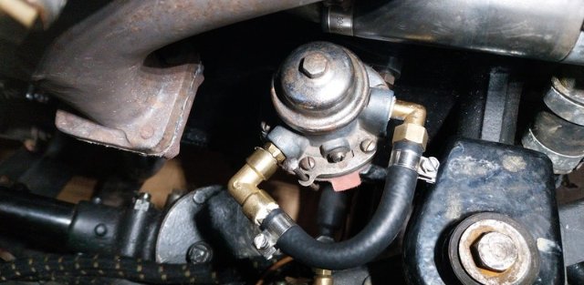

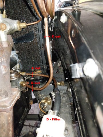

I would now want to disconnect the mechanical AC pump and disconnect the copper pipes at A and B.
I would then connect A and B on the pump side with a hose.
Then a pipe separation at C and a new hose from filter D to connection C, which leads to the carburettor.
AC Pump modifications with A B C D.jpg (57.35 KiB) Viewed 37162 times

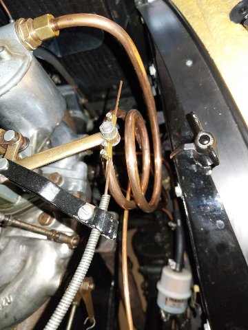

In the other photo you can see the copper pipe loop to the SU carburettor.
Should you keep the loop and use the new connection C or is it better to run the new hose directly from filter D to the carburettor flange?

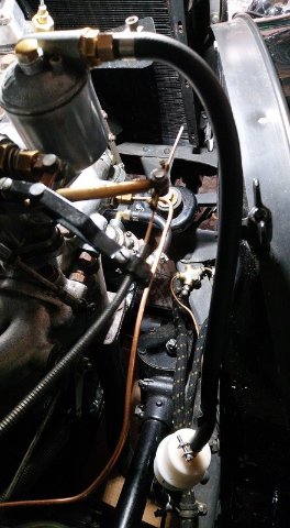

Re: Fuel system for P2 Tourer
Posted: Sat Sep 21, 2024 8:30 am
by ThomasMoRo
That is now my solution:
AC Pump direct connection_8.jpg (44.31 KiB) Viewed 33908 times
neue hardi pumpe eingebaut - hinten rechts _8.jpg (65.09 KiB) Viewed 33908 times

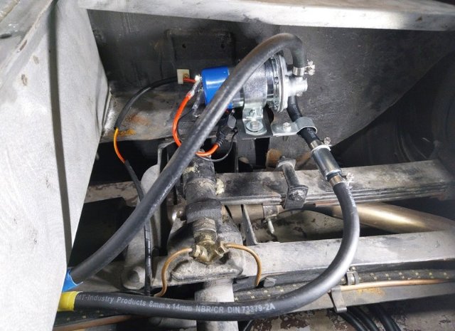

new electric hardi pump under the rear seats with filter from tank to pump and extra pump fuse for 12 volt
from Petrol Filter directly to the SU Carb _8.jpg (34.58 KiB) Viewed 33908 times
Posted: Sat Sep 21, 2024 9:10 am
I can see the exhaust pipe just under the pump, heating it up. Not a good position to choose, both from safety and fuel temp considerations.
Also, just specifying "Hardy" is not enough. High pressure? Low pressure? either are not the correct one by position/pressure.
Finally, rubber pipes are better not be used where they can hardly be monitored, or absolutely necessary. Rigid pipes should be used over there.
Posted: Sat Sep 21, 2024 2:43 pm
by ThomasMoRo
The exhaust is more than 30 cm away from the pump, which is not a problem, especially as there are also the spring assemblies in between, which also dissipate the heat.
