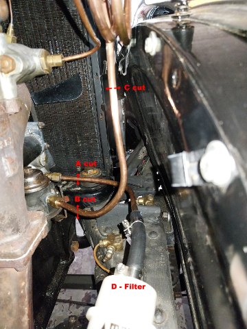

I would now want to disconnect the mechanical AC pump and disconnect the copper pipes at A and B.
I would then connect A and B on the pump side with a hose.
Then a pipe separation at C and a new hose from filter D to connection C, which leads to the carburettor.
AC Pump modifications with A B C D.jpg (57.35 KiB) Viewed 37147 times

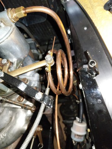

In the other photo you can see the copper pipe loop to the SU carburettor.
Should you keep the loop and use the new connection C or is it better to run the new hose directly from filter D to the carburettor flange?

Post by David2021 » Fri Sep 20, 2024 10:15 pm
As already mentioned, I am pretty sure that the “R” export cars all had SU pumps and Solex carbs.
I would simplify the system and ignore the mechanical pump…you can remove it and fit a plate (and gasket!) to seal it off (fractional power gain!!) Perhaps fit filters before the pump and also before the carb if you are concerned about debris ( I probably unwisely rely on the gauze at the carb!) I would keep the number of joins to a minimum! I had no vaporising nor overheating problem with my 12 tourer in Germany a couple of years ago in July. It was happy at 60mph on the Autobahn…I do have a decent radiator though!

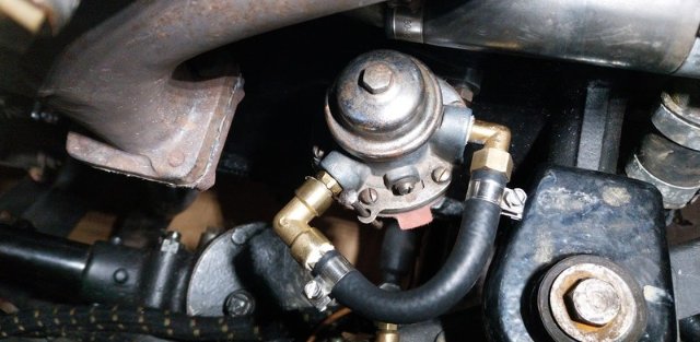

AC Pump direct connection_8.jpg (44.31 KiB) Viewed 33893 times

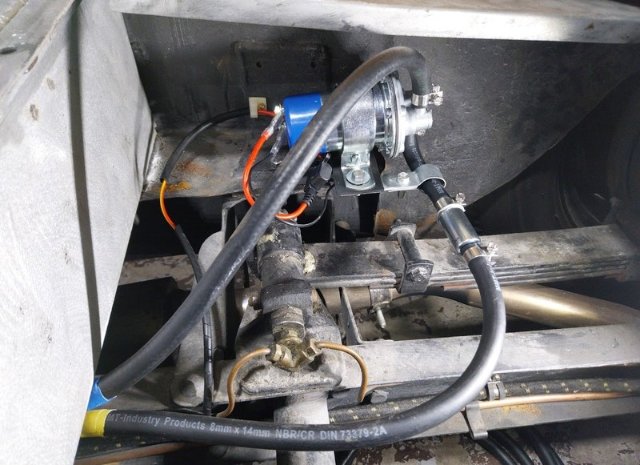

neue hardi pumpe eingebaut - hinten rechts _8.jpg (65.09 KiB) Viewed 33893 times
new electric hardi pump under the rear seats with filter from tank to pump and extra pump fuse for 12 volt

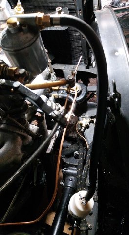

from Petrol Filter directly to the SU Carb _8.jpg (34.58 KiB) Viewed 33893 times

Post by luli » Sat Sep 21, 2024 9:10 am
I can see the exhaust pipe just under the pump, heating it up. Not a good position to choose, both from safety and fuel temp considerations.
Also, just specifying "Hardy" is not enough. High pressure? Low pressure? either are not the correct one by position/pressure.
Finally, rubber pipes are better not be used where they can hardly be monitored, or absolutely necessary. Rigid pipes should be used over there.
The exhaust is more than 30 cm away from the pump, which is not a problem, especially as there are also the spring assemblies in between, which also dissipate the heat.
