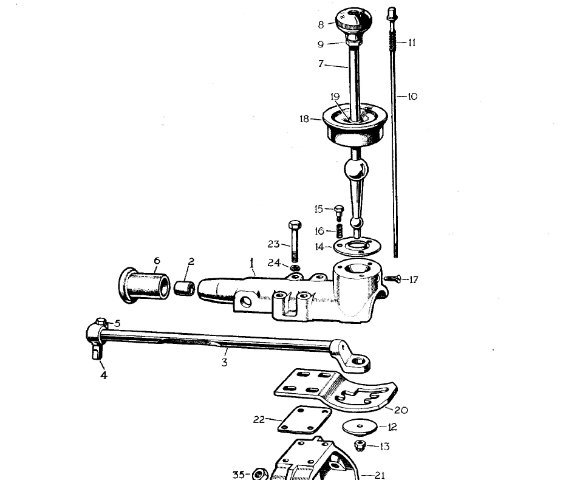

Well I had the rubber cover off & exposed the gearbox top, so gave the selector a good clean up, and did the same to the gear lever. I could see the reverse stop and the disc at the base of the unit, but without removing the remote it did not seem possible to adjust it. So, all back together, clean & freshly greased....Reverse went in fine, but no second gear.......
Took the gear knob back up the stick a bit as I thought I had screwed it down a bit further than before.....Magic! all gears engaging, reverse still a bit of a shove, I have not yet tried it when hot (I have been diverted by fitting LED bulbs to the side & tail lights), but I'm out in it tomorrow, so we will see....
How could altering the location of the gear knob affect the centre reverse push knob action?
Posts: 672
Re: Selecting reverse is difficult
Post by luli » Wed Aug 07, 2024 11:38 pm
All you have to do is turn nut 13 few turns so that disk 12 can reach a little lower.(remove thhe split pin first)
