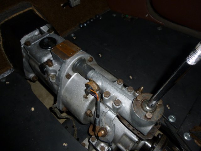

At the NEC on the RSR stand I asked the question & it was pointed out that the engine to chassis earth strap might be missing... sure enough no sign of a strap! Connected the engine to the chassis by using a jump cable.....ALL IS GOOD
Possibly the old worn engine mountings were acting as an earth, and had been for years!
Cable ordered...there is a redundant 1/4" hole in the top of the chassis on the offside...nothing obvious on the nearside...so I will run the new cable from that hole to one of the bellhousing bolts...unless anyone knows better!

Hello David
I think this is the "official" position of the earthing strap as shown in the lower left of the photo. The chassis end of the strap is under one of the bolts securing the engine mount cradle to the chassis. Obviously from the electrical point of view you can put the strap in any convenient place.
DaveM
DaveM

I will have a look and see if I have one there!! If I have, it's not working
