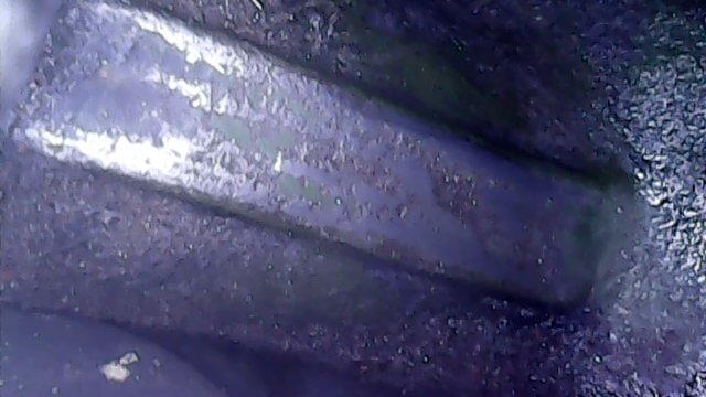

Post by Kitty » Wed Aug 16, 2023 3:59 pm
Thanks for the replys.
The attached shows the engine mount.
Engine mount leg.JPG (41.88 KiB) Viewed 24922 times
I have a letter stating the engine was rebuilt by a local engineer as instructed by Rover!
Thanks again.

Re: 1939 P2 Engine Number
Post by HAD501 » Sun Aug 20, 2023 5:52 pm
Hello
The engine in my car (1947) has no number either. There is a small engine-number plate mounted with the chassis number plate which states the engine number the same as the chassis number. However the V5 gives a different number for the engine. I've no idea how many times the engine may have been changed during the car's life. I vaguely remember reading somewhere (Freewheel, perhaps) that Rover engines weren't always numbered, which might explain the small extra plate. Having said that I do have a couple of spare blocks which are numbered in the expected place - so there we are!
All the best, DaveM
