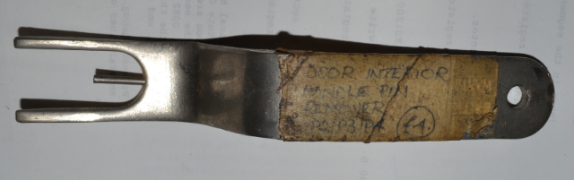

Actually found it. You need to push back the spring loaded fertile and there's a pin holding the handle on.
Re: Tips on taking doors apart
Posted: Mon Apr 10, 2023 12:00 am
There is even a special tool for doing that:
