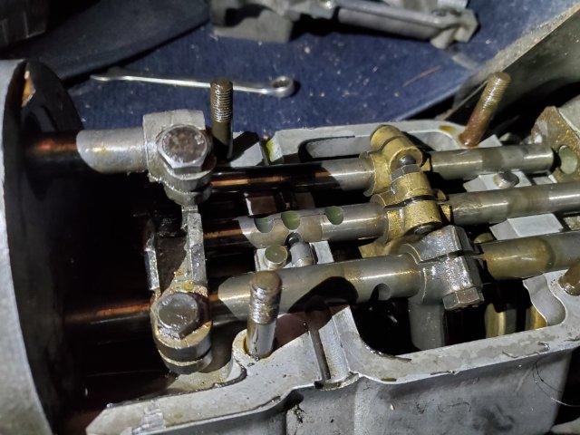

Thanks for reminding me about the gearbox support rubber but I think it is fine. I don't have problems with other gears just reverse and clutchless change works fine for instance. It seems my gearbox mount is different to the Parts book in that the top part has been replaced by a steel strap with rubber blocks under onto the gearbox housing. I dont know whether this was a Salmons version for DHC's or whether a previous owner has done this to overcome a problem. Anyway it seems quite a workmanlike effort so I dont anticipate changing it. You can just see the lower cradle and rubber in the photo with the strap fixed over the housing.http://www.rover-forum.thersr.co.uk/dow ... 4674e0638d
Having just come off a Landrover forum this am I checked out the photo of my uncovered gearbox operating rods as it is recomended apparently that the pinch bolts should all be vertical to get the operating forks in the right position. Mine patently aren't vertical but as there isnt a problem with forward gears perhaps the verticality of the pinch bolts isnt critical? I may however try to straighten up the reverse pinch bolt and therefore alter the position of the reverse fork to see if that makes an improvement
Sorry for some reason the photos only want to be seen in the wrong order!

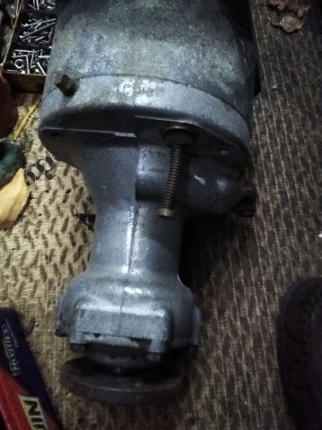

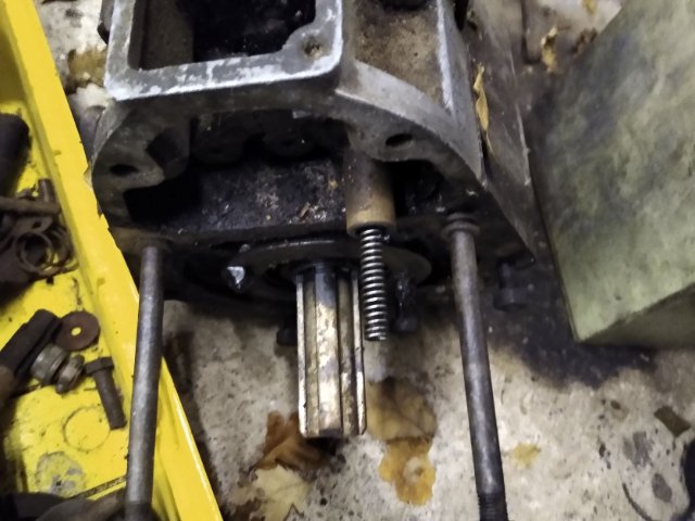

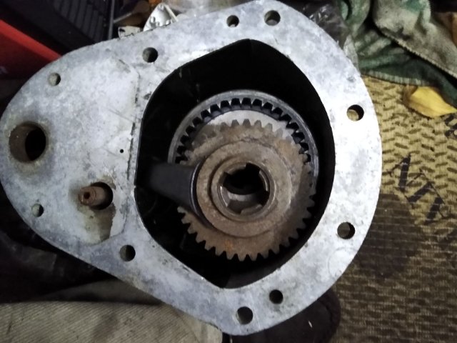

Hello Rob, I've been out to take a few pictures which might be of use . I think I see what you're seeing, but if I'm wrong, just say. The long spring can't be reached without taking the freewheel off. It is completely internal to the two units.
Before you give yourself extra work, can I just tell you a quick tale from last year. It may be irrelevant but here goes. I had a non working freewheel and the culprit was the connection at the gearbox end which isn't an adjustment I had seen anything written about. It's all about the adjustment under the dash but what I hadn't fully appreciated was that when you operate the freewheel, two actions happen. The shaft you see poking out of the freewheel unit into the gearbox has two components. The outer one operates H40/H41 to move the freewheel inner in or out of mesh. However, there is also an inner plunger to H40 which compresses the long spring and has about 1/2"- 3/4" of travel . I can measure it more exactly tomorrow but it is a clearly visible amount. It would seem possible that adjustment of the cable at the gearbox end might help with your problem, particularly if you don't use the freewheel i.e. it could be adjusted completely and definitely "off" if that gave you a reliable reverse selection. My own problem was that the cable needed to be pulled more tightly through its fixing then secured to make it all work properly. You can just see the break right at the end of the shaft in the freewheel where the inner plunger meets the outer rod.
Re: Not engaging recerse gear
Posted: Sat Apr 01, 2023 9:55 am

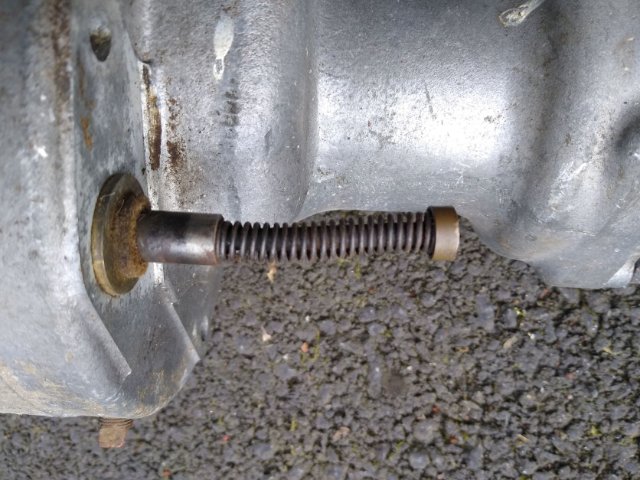

Good morning, I hope these pictures may show a bit more clearly how this works. First, external spring fully released and fully "out":

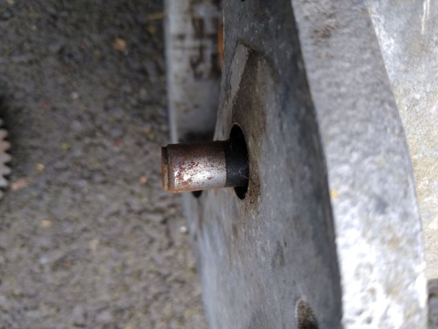

The other end of this shaft, with both plungers fully "in":

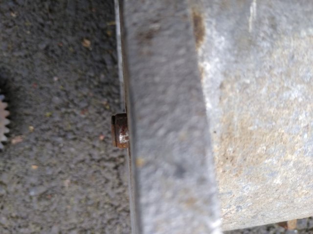

Now the same end of that shaft with the outer plunger "out" :

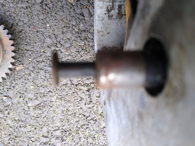

and lastly the inner and outer plungers both "out" (a bit blurry but I think you'll get what's happening:
The outer rod's movement to operate the freewheel fork does not impact on the outer spring. It is only once the fork has moved and the further movement of the cable against the outer spring pressure that the inner plunger moves so it looks as if the correct operation can be guessed from external observation - provided, of course, the internal components are ok. There could be a metal shroud round the external spring partly obscuring your view but I think enough can be seen even with it on. Even if the inner spring were to break, it has nowhere to go and so would seem to stand a good chance of still working to some reasonable degree. I think that I'd be tempted to try a the application of oil on any moving parts of these components that you can reach and if, externally, they seem to be moving ok, try to feel whether adjusting the cable at the gearbox end is likely to be moving both plungers correctly. Should that not work then it's possibly a take apart job. I have found with the unit you see in the pictures that I can make the inner plunger stick "out" even with the outer rod returned to "in" due to the lack of lubrication.

I had the freewheel working fine before and the set up seemd OK. But I have only just clocked the inner shaft (which you call a plunger) in the freewheel shaft where it pokes out of the rear of the box and I have never seen the other end so couldnt work out how it operated.
I shall now remove the the freewheel unit from the spare box to get to that long spring and to calculate whether the freewheel can be removed with the other box still in the car.
A couple of questions if I may? ( Or anyone else can join in)
Will the freewheel unit come to pieces when I remove it or will it stay whole so that it is easy to refit?
Do you think I can remove the freewheel far enough with the gearbox still in situ to get to the long spring and replace it, as I suspect it has disintegrated or was never there?
