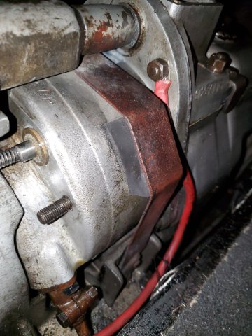

Thanks for reminding me about the gearbox support rubber but I think it is fine. I don't have problems with other gears just reverse and clutchless change works fine for instance. It seems my gearbox mount is different to the Parts book in that the top part has been replaced by a steel strap with rubber blocks under onto the gearbox housing. I dont know whether this was a Salmons version for DHC's or whether a previous owner has done this to overcome a problem. Anyway it seems quite a workmanlike effort so I dont anticipate changing it. You can just see the lower cradle and rubber in the photo with the strap fixed over the housing.http://www.rover-forum.thersr.co.uk/dow ... 4674e0638d

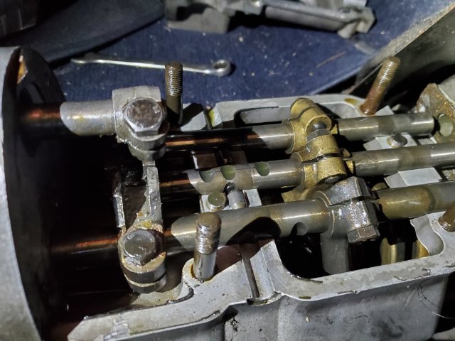

Having just come off a Landrover forum this am I checked out the photo of my uncovered gearbox operating rods as it is recomended apparently that the pinch bolts should all be vertical to get the operating forks in the right position. Mine patently aren't vertical but as there isnt a problem with forward gears perhaps the verticality of the pinch bolts isnt critical? I may however try to straighten up the reverse pinch bolt and therefore alter the position of the reverse fork to see if that makes an improvement
Sorry for some reason the photos only want to be seen in the wrong order!

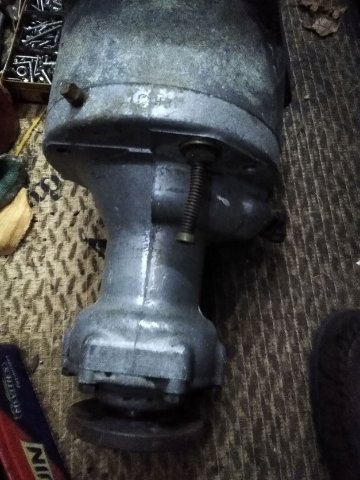

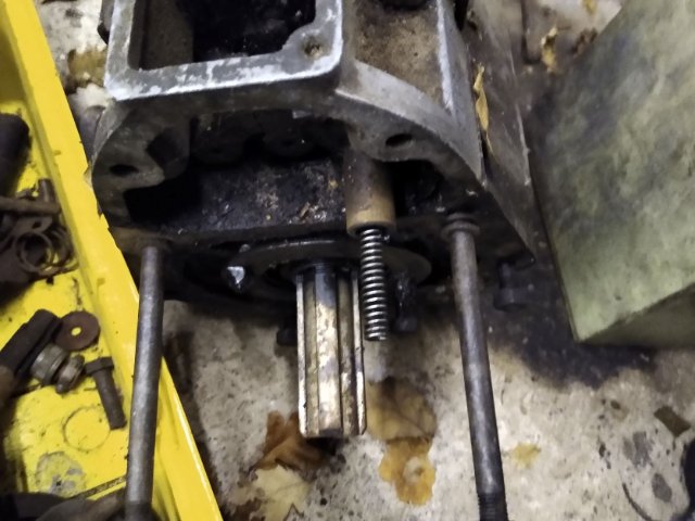

Hi Steve Hyslop again. I have started opening up my spare gearbox and am looking for this long spring which is supposed to be in the reverse shaft. I have the cover off and can see the shaft but cant workout how to get the spring out. Unfortunately I cannot undo the ferrule on the end of the shaft and cannot take the shaft out - there is something resisting it. It certainly has a good spring in there somewhere. As you have just taken your spring out can you tell me how please? Do I have to separate the freewheel casing from the rest of the box to get to the other end of the reverse shaft? The manual gives no clues apart from 'remove' once you have the cover off!
Hope you can help as I cannot feel any resistance from a spring in the reverse shaft of the other gearbox in the car. Many thanks

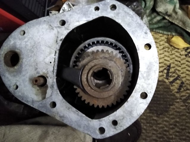

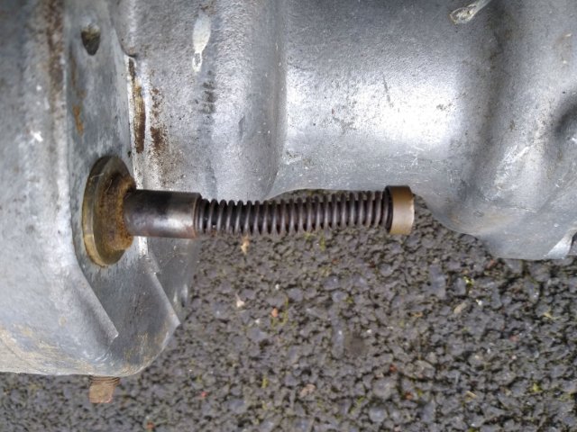

Hello Rob, I've been out to take a few pictures which might be of use . I think I see what you're seeing, but if I'm wrong, just say. The long spring can't be reached without taking the freewheel off. It is completely internal to the two units.

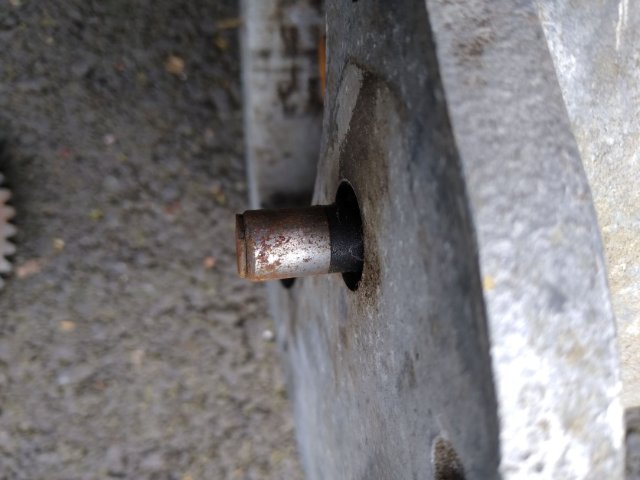

Good morning, I hope these pictures may show a bit more clearly how this works. First, external spring fully released and fully "out":
The other end of this shaft, with both plungers fully "in":

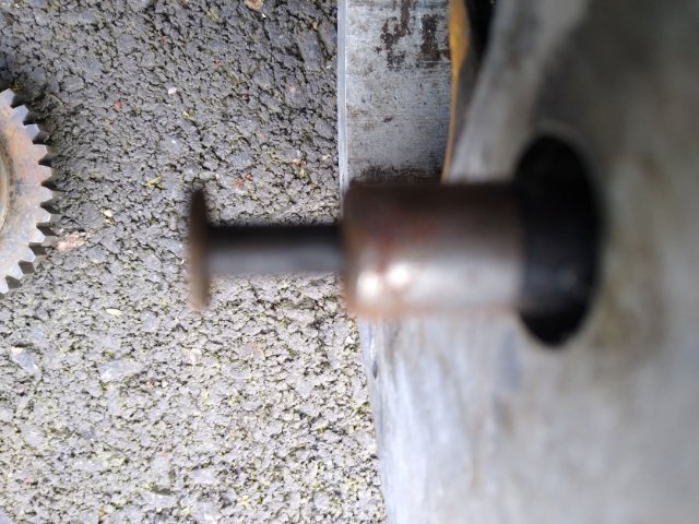

Now the same end of that shaft with the outer plunger "out" :

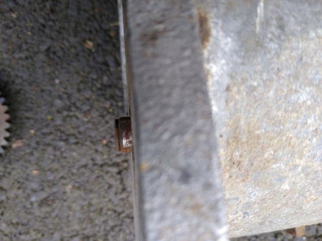

and lastly the inner and outer plungers both "out" (a bit blurry but I think you'll get what's happening:
The outer rod's movement to operate the freewheel fork does not impact on the outer spring. It is only once the fork has moved and the further movement of the cable against the outer spring pressure that the inner plunger moves so it looks as if the correct operation can be guessed from external observation - provided, of course, the internal components are ok. There could be a metal shroud round the external spring partly obscuring your view but I think enough can be seen even with it on. Even if the inner spring were to break, it has nowhere to go and so would seem to stand a good chance of still working to some reasonable degree. I think that I'd be tempted to try a the application of oil on any moving parts of these components that you can reach and if, externally, they seem to be moving ok, try to feel whether adjusting the cable at the gearbox end is likely to be moving both plungers correctly. Should that not work then it's possibly a take apart job. I have found with the unit you see in the pictures that I can make the inner plunger stick "out" even with the outer rod returned to "in" due to the lack of lubrication.
