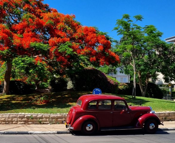

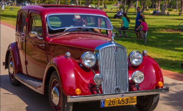

This is my contribution. You can follow the other chapters describing the painting step by step, part by part.
https://lulis.org/2012/11/01/26-453-%d7 ... 94-%d7%94/
10 years have passed since painting, and this is how the car looks today:

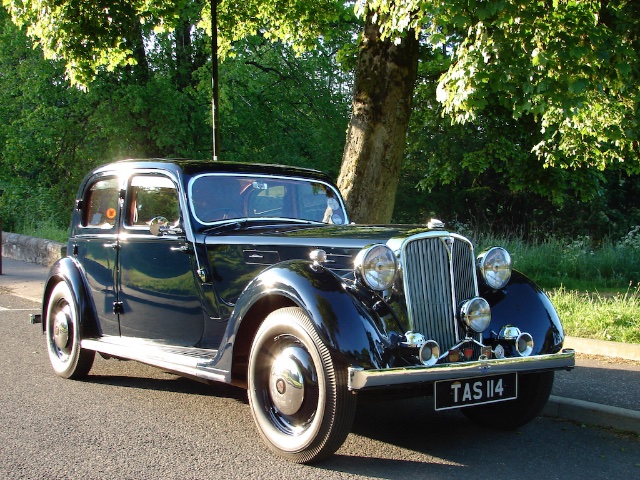

The paragraph below was the paint procedure my car went through when Royce Cole restored it between 1975 and 1982. Royce was not in the car trade but was an amateur enthusiast who could turn his hand to anything he put his mind to. 30 undercoats were applied to my car which even to this day I find hard to comprehend and 2 months to let it dry in the Australian heat. The results were simply stunning and when I sold the car more than 35 years after it had been painted it still looked amazing
The painting came next. After sanding the whole of the metal with an orbital sander and hand block, I filled the rough spots with plastic body filler and sanded smooth. Deoxidene, etch primer and 30 undercoats were applied and left to dry for about eight weeks before sanding. Two light coats of colour were sprayed and the whole sanded to show up faults. The painting procedures are detailed in the Dulux publication “The Complete Refinisher” but not enough emphasis is placed on allowing plenty of time for drying of undercoats, two months if you can. I used all Dulux products, finishing in Admiralty Blue acrylic lacquer. One of my friends in the ROC helped me get the paints at trade prices, which I much appreciated.
