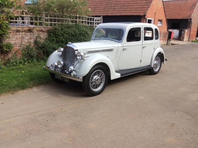

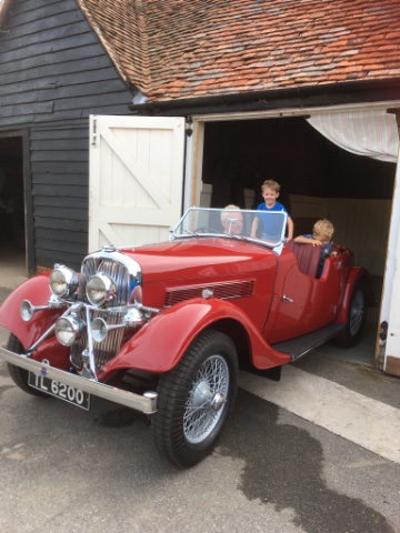

Hi,
Just to add to the excellent advice already provided; in my experience, 2k paint is the only practical option now that all the lead has been removed from cellulose paint. Modern cellulose gives a great finish but it just doesn’t last like it used to. I’ve just had my Tourer repainted in 2k as the car was so much better than the cellulose finish I had given it eight years ago. That said, I gave the primer coats on my Saloon several months to harden off and the finish has remained reasonably good. But who wants to spend a year painting a car?
Both my cars were stripped down completely so that each panel could be painted inside and out before reassembly. I’m unsure how original this approach is but my concern was to ensure the metal was as well protected as possible and it is so much nicer when looking under a wing or bonnet to see body coloured paint plus this also ensures that the beading strips, window rubbers and glass etc are free of overspray.
Regarding the colours; neither of my cars wears original livery. I reasoned that, since I’m footing the bill and doing the work, I can choose the colour I will enjoy the most. I suppose my logic is a akin to enjoying the luxury of wool car mats, rather than saving them for the next owner by laying down rubber! Of course there is no denying that our fine Rovers are a piece of history and ownership carries with it a degree of responsibility not to spoil things for future owners. With that in mind, colour schemes should, in my view, be in the spirit of the original if the original colour is not to your liking.
My Tourer is bright ‘Italian Racing Red, as it has been since the early 50s and has received very positive praise at shows since repainting in that colour. I do wonder if it would cut a similar dash in it’s original drab maroon? Likewise my Saloon is very attractive in ‘Light Aircraft Grey’ with contrasting red leather seats. I opted for this after a much younger colleague said my car was nice but it did look like a hearse! Knowing that preWar Rovers are not as highly sought by the younger generation as they deserve to be I felt a more cheerful colour scheme would make it more appealing.
Fair to say that the ‘holy grail’ for any classic car owner is to have one exactly as it left the factory when new. Such vehicles are greatly admired and will attract the best prices. However, this level of perfection usually comes at a cost that cannot be recovered so the restoration challenge for the average owner is to create the best car you can at a price you can afford, mindful of the resale value!
Good luck with your car and it is really impressive that you have a daughter with a keen interest in Rovers. Some progress pictures as your restoration continues would be of great interest.

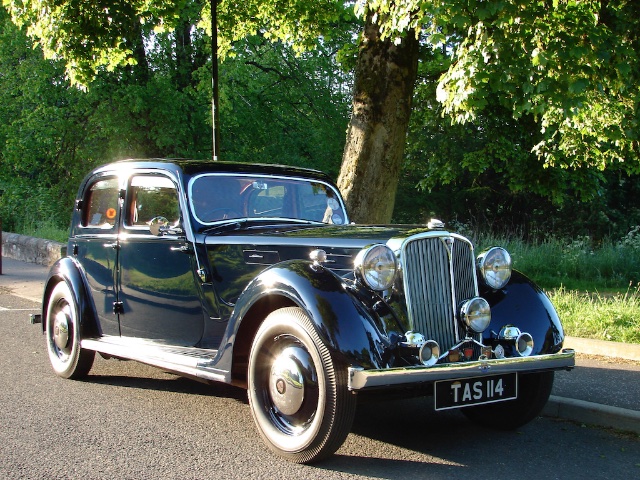

- D8A6FF3F-4833-4A66-B3C6-A9EC14BCB5B5.jpeg (127.71 KiB) Viewed 12723 times
- AFCBC962-51CE-441E-9369-43B531E472FF.jpeg (78.87 KiB) Viewed 12723 times

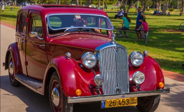

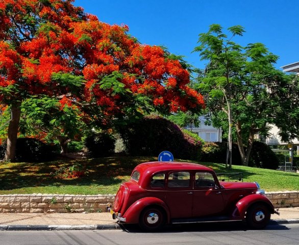

This is my contribution. You can follow the other chapters describing the painting step by step, part by part.
https://lulis.org/2012/11/01/26-453-%d7 ... 94-%d7%94/
10 years have passed since painting, and this is how the car looks today:

The paragraph below was the paint procedure my car went through when Royce Cole restored it between 1975 and 1982. Royce was not in the car trade but was an amateur enthusiast who could turn his hand to anything he put his mind to. 30 undercoats were applied to my car which even to this day I find hard to comprehend and 2 months to let it dry in the Australian heat. The results were simply stunning and when I sold the car more than 35 years after it had been painted it still looked amazing
The painting came next. After sanding the whole of the metal with an orbital sander and hand block, I filled the rough spots with plastic body filler and sanded smooth. Deoxidene, etch primer and 30 undercoats were applied and left to dry for about eight weeks before sanding. Two light coats of colour were sprayed and the whole sanded to show up faults. The painting procedures are detailed in the Dulux publication “The Complete Refinisher” but not enough emphasis is placed on allowing plenty of time for drying of undercoats, two months if you can. I used all Dulux products, finishing in Admiralty Blue acrylic lacquer. One of my friends in the ROC helped me get the paints at trade prices, which I much appreciated.

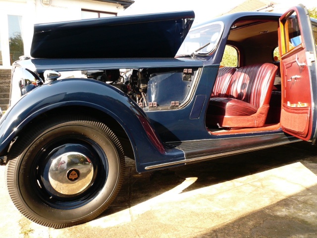

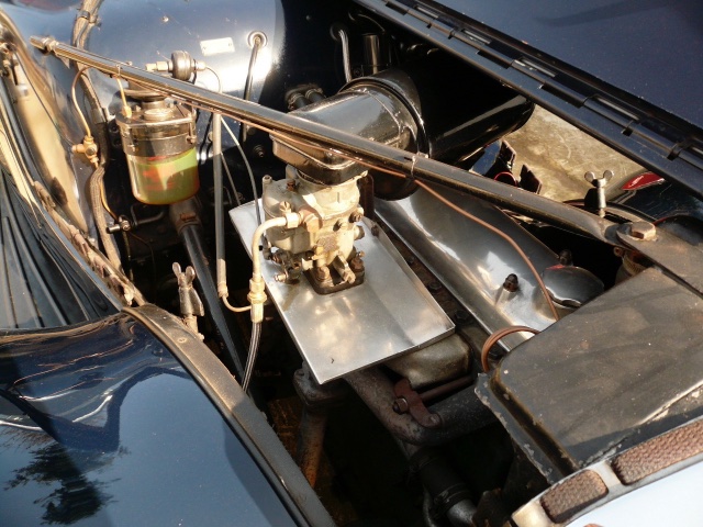

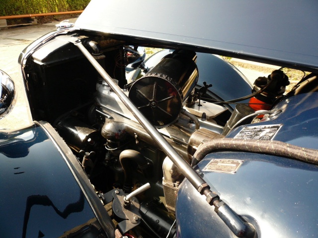

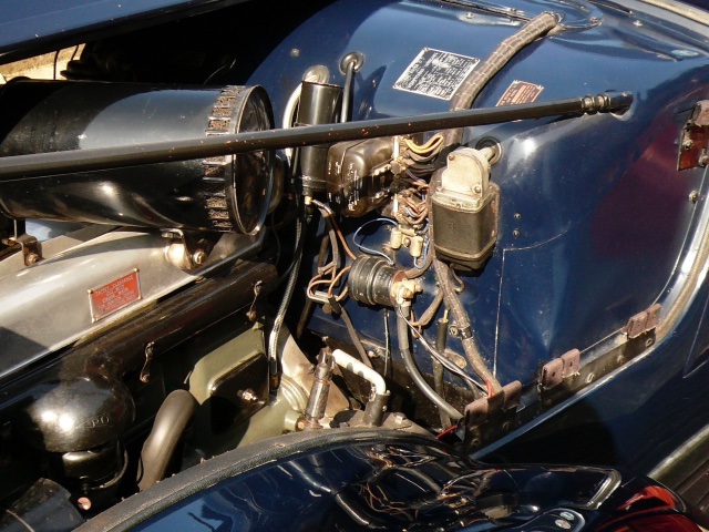

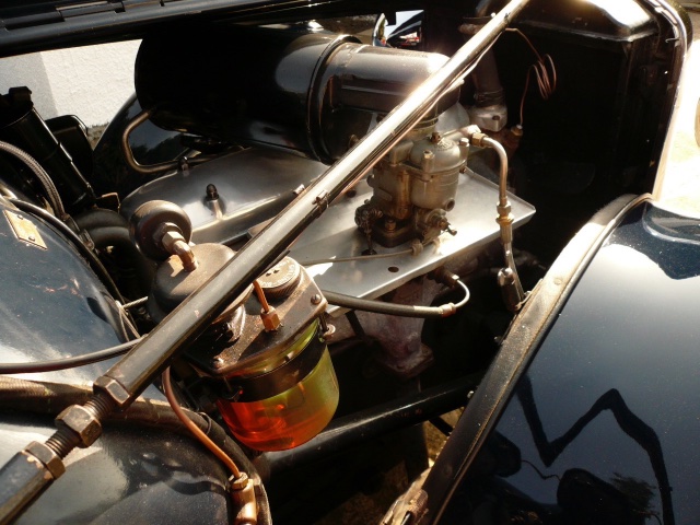

Any pics of under the bonnet? The bulkhead. I need to decide whether that is to be body colour or something else.
Our car is more or less in pieces. So I will paint the panels off the car.
Not sure about 30 coats of primer. But then again. I did a car not so long ago that had poor body work and there was a lot of prep before that first coat.
These days you can get much higher build primer so don't need so many coats.
Re: Paint schemes
Bulkhead is body coloured but not to a high glossy finish

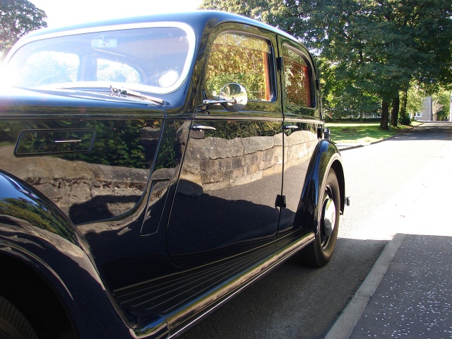

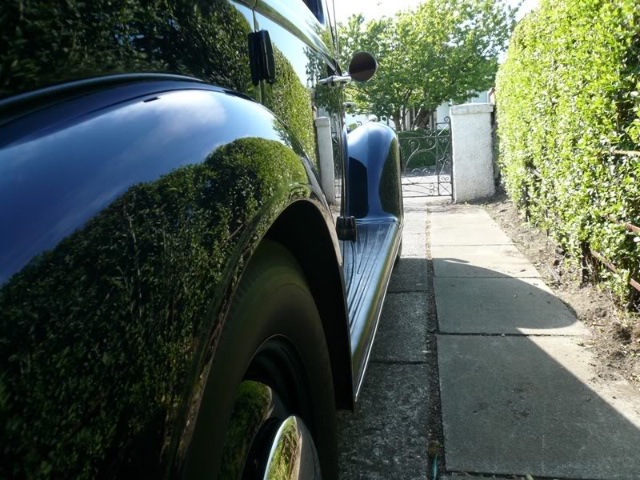

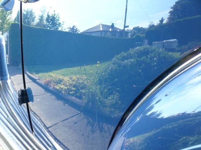

Here's a few reflection shots of paint that is over 35 years old
I guess that's what 30 undercoats left to dry in the Australian heat does
