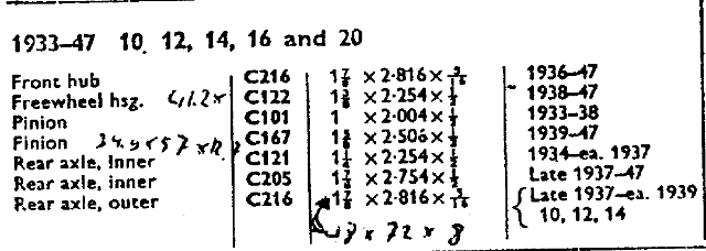

In among my spares I have a new oil seal (about 2.75 O/D 1.75 I/D) it is marked NTK1075. What might it fit? Hub seal?
The envelope it is in suggested it came from a classic Rover supplier.

This is the list of oil seals for the P2 range:

Thanks Luli
It is certainly the Inner rear axle seal!
Remarkably few seals on Rovers!
Thanks for republishing the list

For Information
Payen C167 became Payen NA224
C122 became NA213
C205 became NA236
C216 became NA 239
