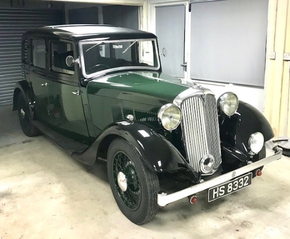

- P1.jpg (55.7 KiB) Viewed 23151 times

Thanks for the picture, your car looks excellent! A really smart colour combination. From the registration number your Rover must have started life in the same part of the country as the Tourer used in ‘All Creatures Great and Small’.
