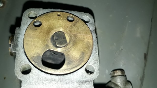

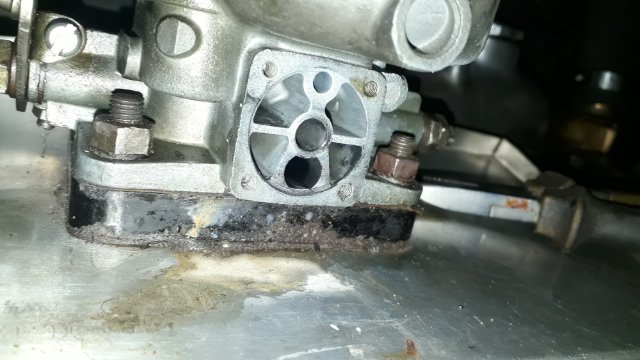

I ahve been trying to understand the bi-starter on my 30 FFA1 Carb. Is it correct that when the engine is warmed up and the choke fully home that air is still being drawn in via the starter air jet? When I put my finger over the jet the engine stops so its not a little amount of air. The carb is as supplied complete after refurbishment and looking at the bi-starter disc I cannot see a different way it could be fitted to close the air off.
Perhaps someone could explain it to me?

It shouldn't be like that. Have you tried to turn the disk 180 deg? or flip it over? I have found some defective bodies that suffer from this issue and I had to scrap them.

When you say 'it should not be like' that did you mean the main carb body or the bi-starter unit with disc?
I looked at the parts photo in your link and I see there is a paper gasket shown. Bearing in mind that mine is a 30 FFA1 (twin choke) rather than a 30 FA1, Is this gasket supposed to be between the bi-starter and the main body? As I dont have any gasket at all. If it is do you have a source or a template please?
I tried turning the discs thro 180 deg but then the notches for the operating steps would not meet the ball bearing so that was wrong. Unless the outer disc only was installed the wrong face round. I might try that.

I removed the bi-starter again to reverse the pierced disc but I could not see how to remove the disc from the shaft. I didnt want to force it off as it probably wouldnt stay on when replaced. Any ideas?

There is no paper gasket. What you saw is the gasket between the carburretor body and it's bottom section. just make sure that the surfaces are flat and there are no scratches. In a well functioning carburretor you should be able to tune the engine to a very low RPM and no air draw from the bi starter air jet. If this is impossible then the body is damaged.

A little gentle force. Take the opportunity to clean and polish it. BTW a friend of mine purchased the same carburretor, for 50 pounds from Freddy Boulton. Excelent condition. May be he has another one.

I have been looking long and hard at the photos of the bi-starter disc etc and concluded that I cant reverse the disc because the holes would be in the wrong sequence. My thinking is this: the the large rrounded rectangular hole is the air vent. Opposite this on the disc is a medium size round hole which corresponds to the round hole in the body and is the full choke. Next to it is a smaller hole which comes over the round hole in the body at half choke. There is a second medium size hole somewhat isolated which I dont understand. If I reverse the disc then the small hole would equate to the full choke position and the medium hole to the half choke because the disc is always turned the same way by the lever. Please comment if you think I have got this wrong.
What I suspect now is that the disc is not sealing against the body apertures fully and air etc is leaking to the wrong areas. This is perhaps evidenced by the dirty staining around the air hole in the disc. The spring seems pretty strong so maybe not that. I shall polish up the disc and the mating body faces and see if I can get a better contact.
I look forward to any comments on this
