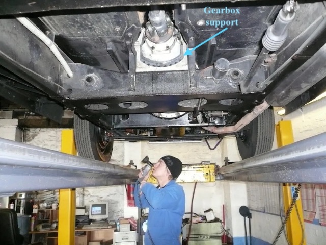

Check the rubber support between the gearbox and crossmember is in good order. They go soft and collapse with age/oil contamination and cause the symptoms you describe

Post by luli » Fri Jul 29, 2022 8:45 am
A good point!

I feel a bit dumb now beacuse having studied the pictures I can see the slotted holes in the gear change gate are obviously for adjustment. Rereading the workshop manual more carefully I see it does flag up that refitting the UJ cover on the stick you should avoid nipping up the springs/bolt shoulder and inhibiting the plate movement. So I shall get onto that as soon as I have the current job done. I hadnt considered the rubber mount as a possible culprit but I had better check that as well!
